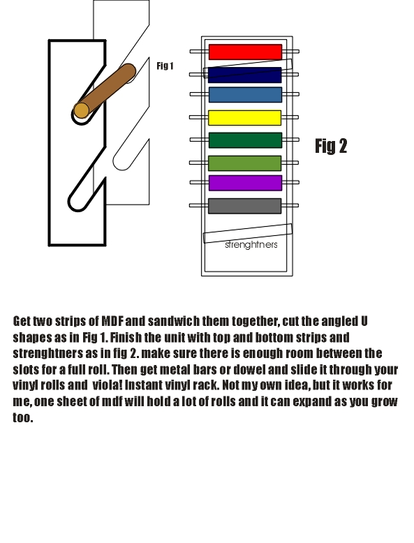

quote KARL WILLIAMS:Have to taken this piccy just for me?
No Karl.
it was to help all the other board members save money as well!
but better to drill the holes in the right place first time though, unlike me!Peter

looks like someone replicated the demo i did on vinyl racks a few years ago. not to worry… i wouldnt have done the demo if i didnt expect/hope people to use it. :lol1:
i built my first set of these about 9 years ago, actually still have them i think, though have done a good few more sets for our walls.

BTW if using Robs drawings, increase the measurement twixt the rails,
otherwise full rolls wont fit!Peter

unless every roll on your rack is a 50 metre roll then yes, increase the slat spaces. 😉harry, not a problem at all mate… if you remember where you got it, post a reply to it, linking to here. bet it doesnt last long on that site 😀 😉 :lol1:

As for Rob’s demo on the vinyl racks,I would say most people on the boards have used it. Definately best way to store vinyl, just can’t be asked to paint mine…one day perhaps.

I had some metal vinyl racks which were supplied to me with some other equipment when I first started, they were OK but they were quite expensive and they actually make it quite difficult to see what vinyls you have in stock, something like Roberts idea store as much vinyl and it is easy to see what you have in stock really easily.
Off to B & Q on Saturday for the MDF and me jigsaw’s coming out! Thanks lads!
