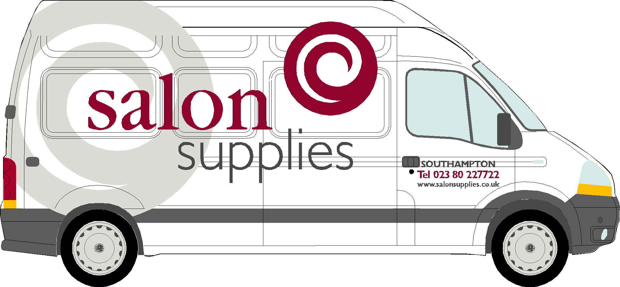

    Morning everyone
    could I have some advice please on what vinyl to use do the large grey logo on this van, for all the other bits I will use Mactac 9800 series.
    Do you think 9800 will be fine for the big logo or should I get a good cast vinyl in?
    We use 9800 for the majority of our jobs but I am a bit unsure whether it will stay in the recesses on this van.
    thanks very much
    Neill

  • David McDonald
    20 October 2006 at 21:29
    Hi Neill
    Just a thought – its a grey logo on a white van, why not just cut round the recesses and don’t try to mould into them with heat. Yes you will see the about 5mm white on the inside edge of the recess but it will be hardly noticeable (grey/white), cheaper polymeric vinyl will suffice and you’ll get the job done quicker. Maybe give the customer the choice???
    Macky
    20 October 2006 at 21:46
    movana recess is quite gentle so consider macfleet, or mac 9800,
    it will do the job, and a lot cheaper
  • Richard Urquhart
    20 October 2006 at 21:52
    as peter has said the recess on this van are not bad im sure 9800 would be fine i do these vans for vauxhall parts and have used 5 year printed and these go in and out of the recess and are fine
    let us know what you go for
    rich

  • Neill Hague
    23 October 2006 at 07:44
    thanks for the advice guys, very useful.
    We have used Mac 9800 for many years & like it very much. I thought it would be good for a logo of this size but just wanted to see peoples thoughts.
    We have slit around the recesses before like Macky suggested & may go for this again, as the grey is very pale.
    Any way once the van is done I will put up a picture.
    cheers guys
    Neill

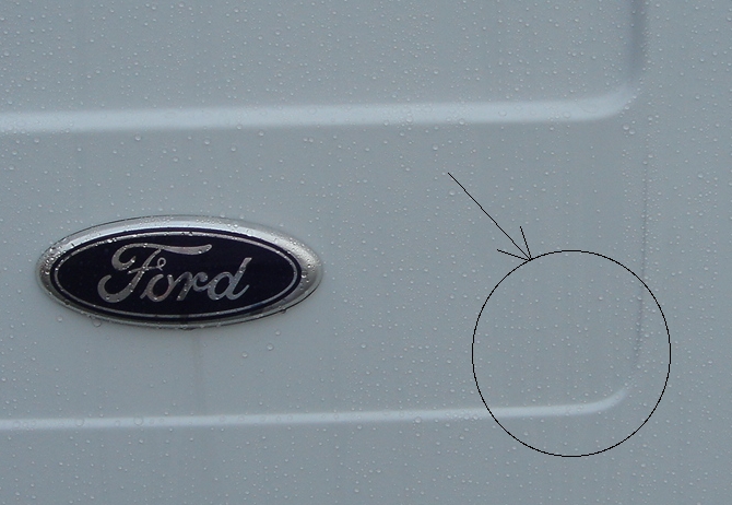

    23 October 2006 at 08:21
    I’m afraid that I can’t agree with my colleagues in this one.
    The bit of the Transit rear door circled in the picture below is hardly severe but I have had calendered vinyl pull out of there on too many occasions.
    Having said that, my view is coloured by the fact that when vans leave here they often wind up at the other end of the country and rectification costs are too expensive to take the risk. I accept that if it is a local van, that can be easily and cheaply be brought in for a bit of rectification if needed, then it might be worth the risk of using a cheaper vinyl. I would still be reluctant though.
    I still stick by Avery 900, or any good cast.
