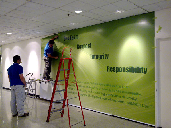

    This is how we fit.
    We make sure our panels are all trimmed to the same height and have overlap lines on both panels. Also have a bleed top and bottom and left and right.
    We install the first panel. Then to install the second panel I hold the panel so its at the same height. I move the second panel so it aligns with the overlap mark on the first panel (when you apply the first panel don’t trim it, trim later). I put a piece of tape on the panel overlapping the first panel. I then tilt the panel so the bottom of the panel meets the overlap mark at the bottom. Once in place I then put another piece of tape. I check it then put a permanent hinge in place and apply.
    Never done it wet. Could never find a bikini that suits my body shape.
    This job I think was 8 panels about 2.7 metres high. They were around 110cm wide as well.

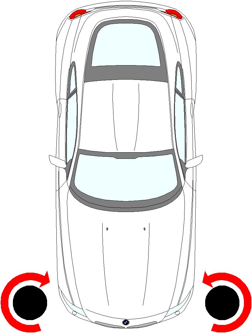

    I appreciate what you are saying mate, but any mechanical car wash i have been in the rotating brushes travel to the rear of the vehicle, stop, then travel back towards the front. so the brushes will come up against the overlap whatever way they are applied?
    also, lets say a mechanical car wash only travels one way, from front to the back, the exact same would apply for multi-layerer vinyl graphics and we don’t hear of failings of this around the world or the vinyl manufacturers would have to go back to the drawing board.
    Please dont get me wrong, i understand its safer etc to start from rear forwards, just that i personally think most failings come about as a result of either the vinyl used or how it has been applied.
    6 September 2010 at 09:07
    Most car/truck wash brushes rotate in the direction the vehicle travels, so in effect the leading egde of the brushes would strike the edge off the the vinyl that is facing the rear,
    Which actually argues against starting at the rear if this is the reason why you should start at the back?
