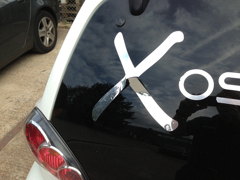

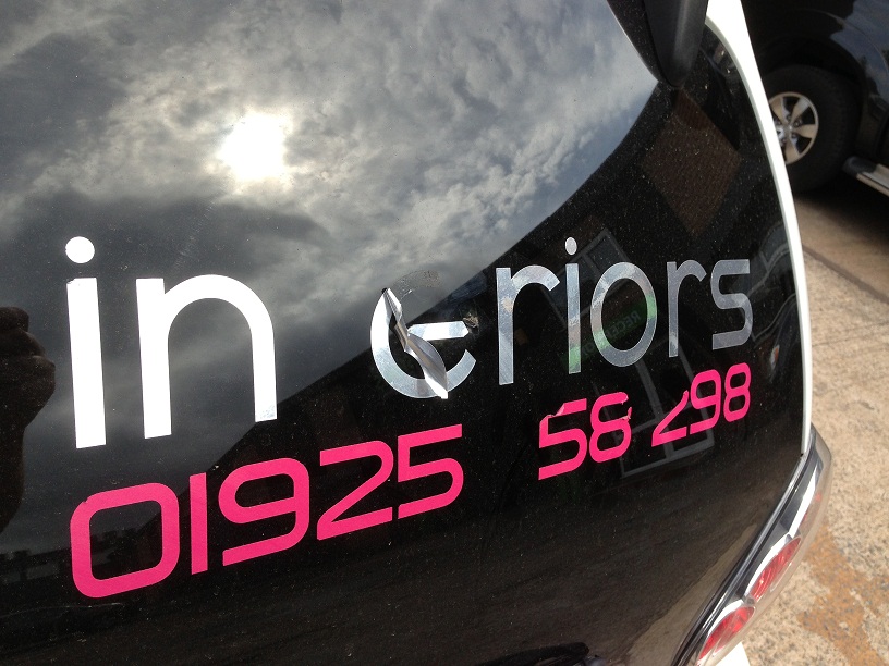

    this will be the third time we have done this back window on a car. We have cleaned the glass with allsorts, isoprop, meths, going to try thinners this time.
    The graphics seem to stick mostly but in places it just doesnt stick at all and comes away as per picks.
    Its not a problem with the chrome as it is on the rest of the car and sticks fine to the paintwork. Its just the glass were having a problem with.
    Its quite a new car and I am wondering if the glass is some sort of ‘stay clean’ type (although you wouldn’t think so) and requires one of the new ‘Nano Cleaners’
    Anyone else had similar problems
    cheers

    If they have used Rain-X or similar stuff on them then it can cause problems.

    We experienced this on a rear window of a vehicle a few years ago when applying chrome direct to the window. We now cut the lettering in black and apply the chrome on top 😉

    Nano technology is used on glass to prevent build up of dirt, some advertise as "self cleaning windows" the is the remover.
    I have never used this product before but for the sake of a tenner it might be worth trying and getting some feedback

    just a thought most chrome and some vinyls have a water based glue which i have had the odd problem with when on glass
    1 July 2013 at 11:06
    I’d say Rain-X is the culprit.
    I had a problem fitting shop windows about a month ago. I assumed it was because the shop was across the street from a fast food place (airborne grease)
    But the shop owner said that the windows were installed just the month before. I think they had some sort of a protective coating.
    Cleaned with 91% isopropyl (sp) alcohol and that seemed to do the trick.
