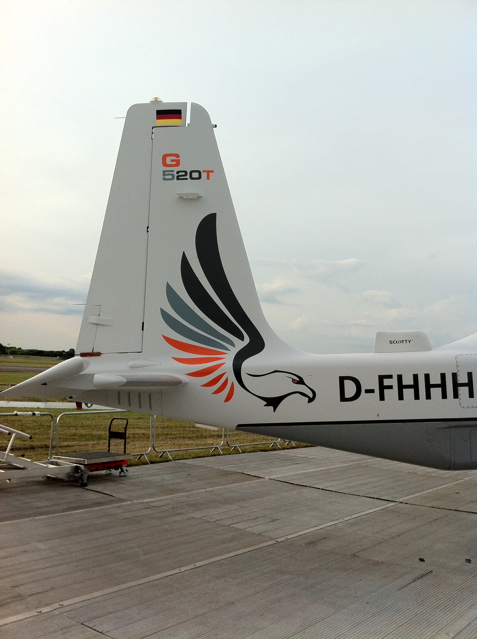

    Like this Hugh ?
    12 April 2016 at 11:11
    Pretty much Ian, yes! except he wants the whole tail & rudder wrapped red… I said I’m not wrapping leading edges due to stitching and will just do near full panels each side, from a distance you’ll not really see the 1" borders!
  • Iain Pearson
    12 April 2016 at 11:48
    Good thinking Hugh
    Aircraft is not a common vehicle amongst most companies/installers so many would attempt it with standard vinyls and leading edges – and then watch as the plane undresses itself on its first flight lol
    Keep us posted, would be good to see some pictures :thumbup2:
