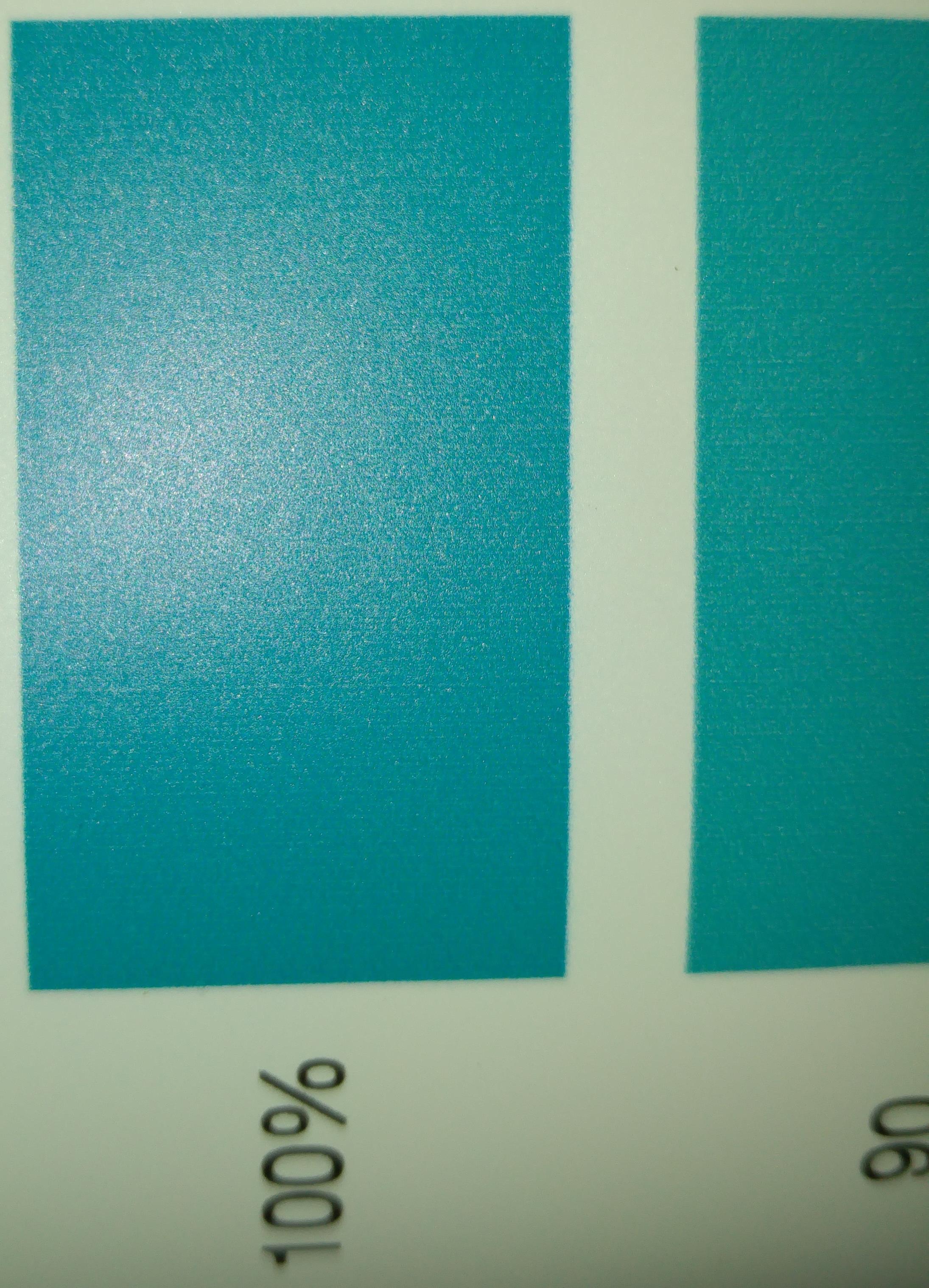

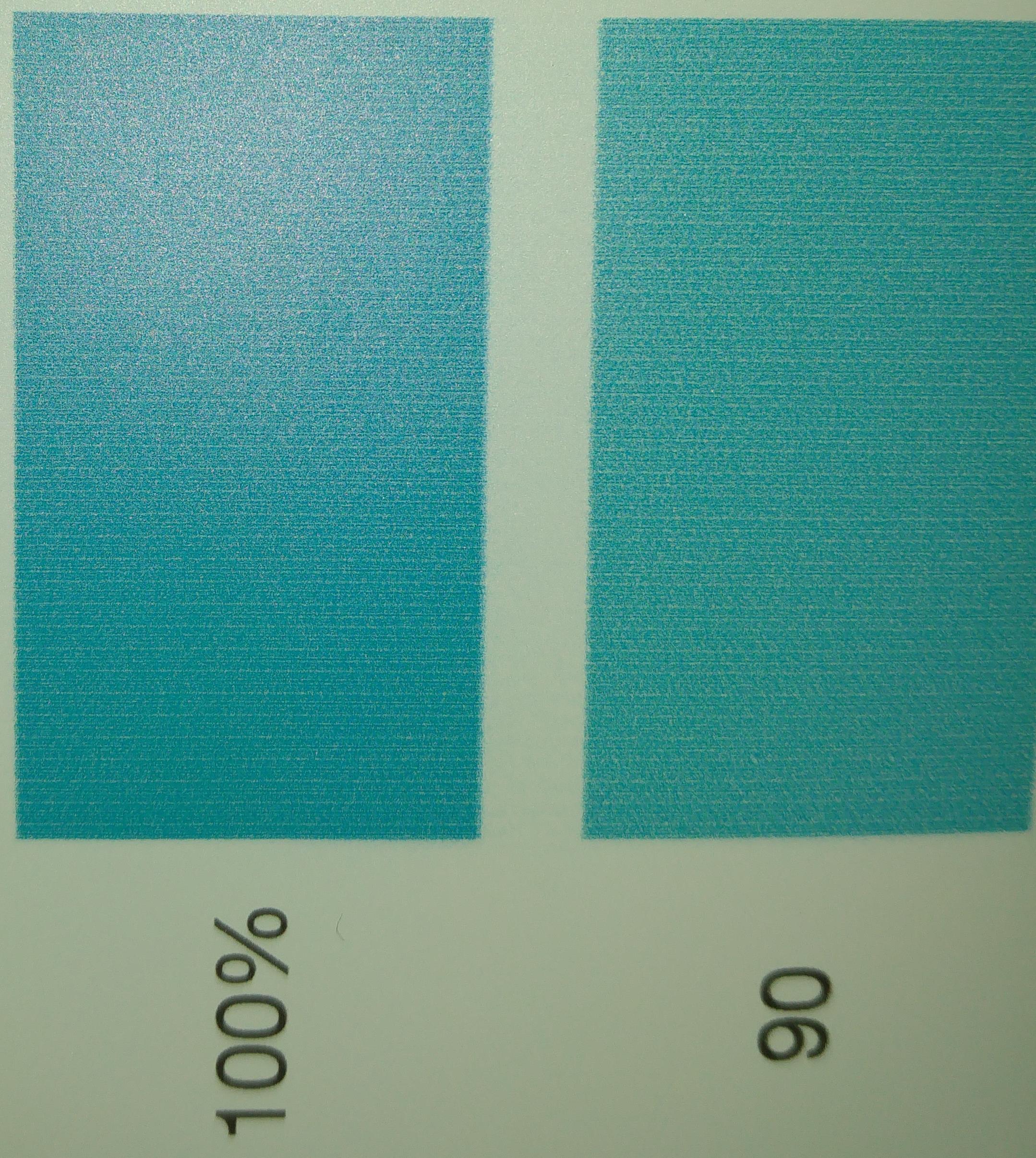

    I’ve changed the heat profile to 30/30/40/50 and added a fan heater below to preheat a little more. I’ve also changed the dotsize to small. Fingers crossed it seems to have worked for now 🙂
    The grainyness in the yellow seems to have reduced significantly so I’m guessing it was pooling on the surface and fisheyeing due to surface tension or something like that. Although the cyan seems to have gone a little bandy and fuzzy now! I’ve not tried it on paper yet so I’m not sure if it’s just the vinyl
