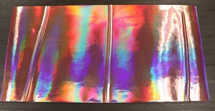

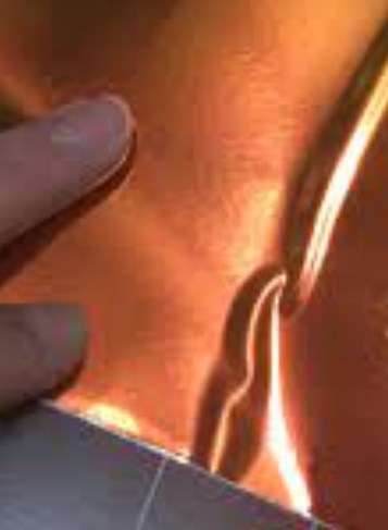

    Hi team
    we are having some problems with our vinyl. when it is rolled out on the table it is lifting and creating what i think its called “tunnels”. we can work around it but we are also getting it doing it when cutting and its catching letters now and causing machine jams.
    is there an easy fix for this or anything we can do to limit it? 😟

    I’ve only ever had this with chrome/ gold leaf and other rigid sort of vinyls and the only way I know is to roll it loosely and not round a normal cardboard tube.

    Chrome and Gold are common to have tunnelling.
    They are a polyester film, rather than vinyl. If they have been on the shelf for long periods, they tend to form the curvature of the roll they are wrapped around. so when you lay it out flat, or try cutting it, the tunnelling starts to happen as it lifts itself away from the lining paper.
    I do not think it is just as common with vinyl, but I have seen it and I am of the opinion it is either wound too tight on its core, under tension when laminated or again, it has been on the supplier’s shelf for too long because there is a two-year shelf life on vinyl. but that’s once it comes off the manufacturing machines, then transport to countries around the world, then sitting in your supplier’s warehouse, then on your shelf, before use!

    i had this happen to me a while back. chrome vinyl and it was a pig to weed. i went for my lunch and by the time i got back it had all started to lift like those pictures show. i called my supplier demanding a new roll. a complete waste of my time and not fit for purpose! 😠
