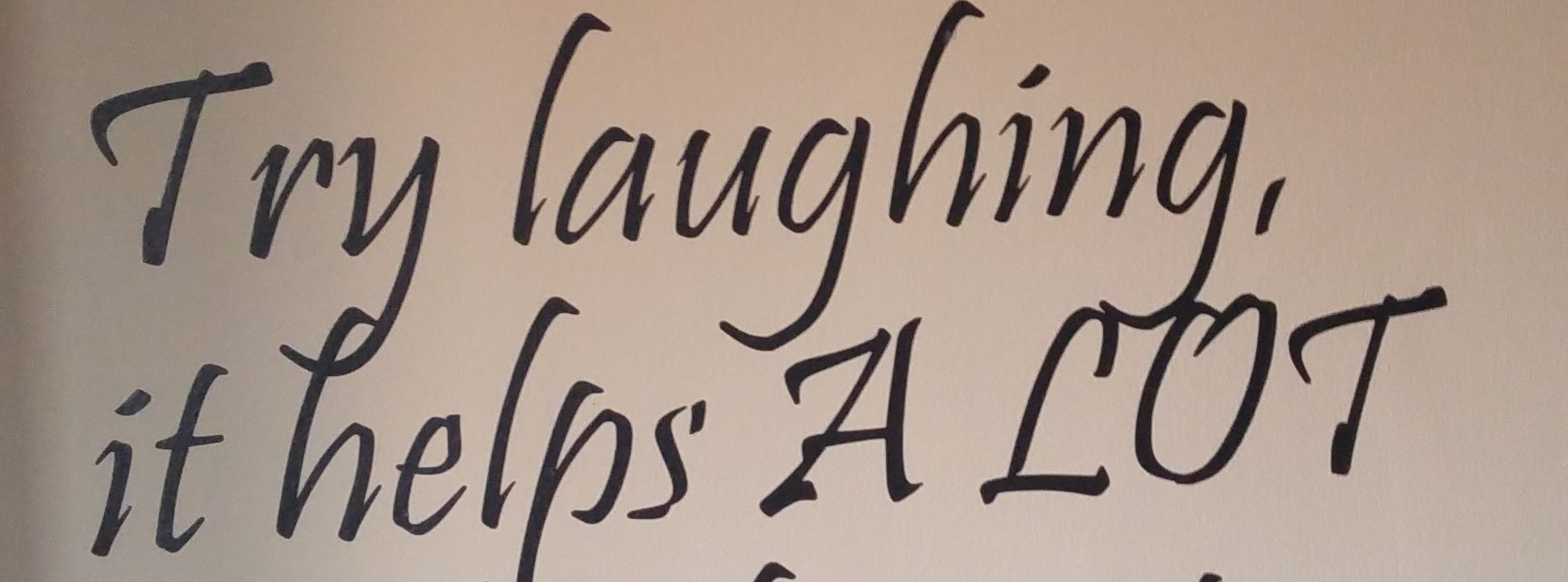

    13 February 2016 at 08:32
    Admittedly the only one I’ve tried but I have used Uber-film UM in matt black, I’ve used it on a few walls around the house to test it and over a year later it’s still not lifted – and one is in the front hallway so loads of traffic and kiddy fingers. Quite small text too around 1" high in some places and about 3mm in width. I thought that would be a good test and so far so good!
    It didn’t however stick well to rough surface painted fibreglass, it’s just not sticky enough and to be fair I didn’t expect it to either.
    Also, as it’s black I haven’t tried printing on it (whats the point!)

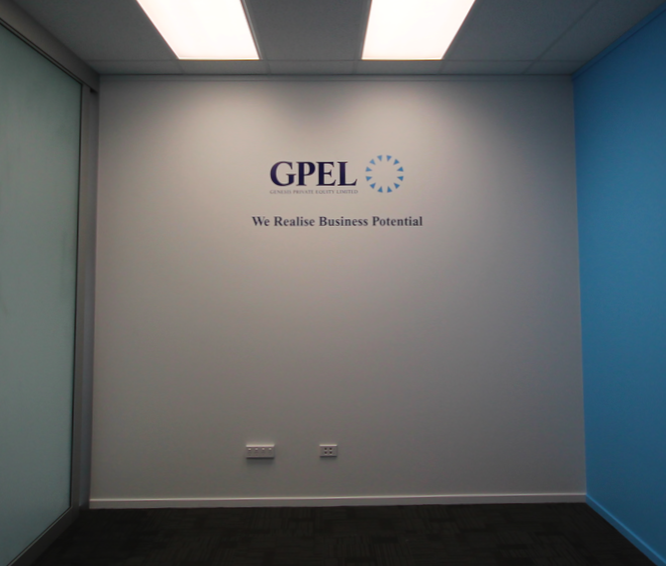

    I always Metamark M4 MATT for cut vinyl on wall applications. 10 years, never a call back. Matt vinyl on walls hides the imperfections of the plaster / paint job better than gloss vinyl.
    Once I didn’t have particular colour in matt and decided to laminated M7 with matt laminate. Didn’t work. Maybe was too thick, maybe the office was too damp (rail arch) vinyl curved and felt down on the office floor. Had to replace by ordering M4 – no problem.
    The installation included 4 other different colouts M4. Only the laminated M7 with matt lamination, fell on the floor. All other M4 stayed up without any issues.
    I’m sure if the surface was van or glass panel – the laminated M7 would of been just fine.
