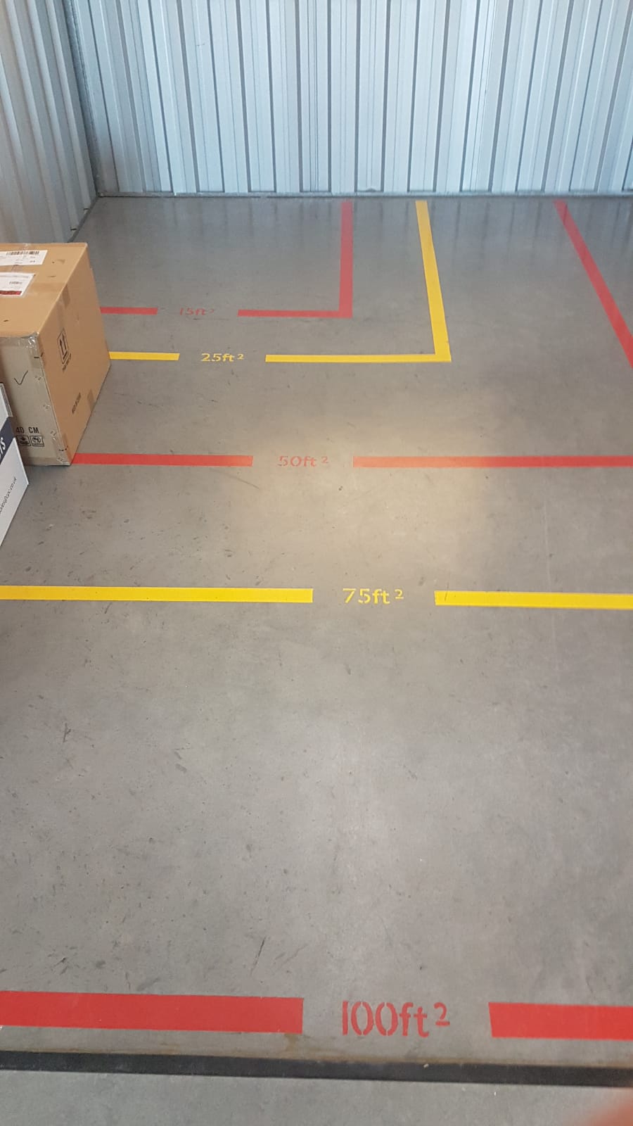

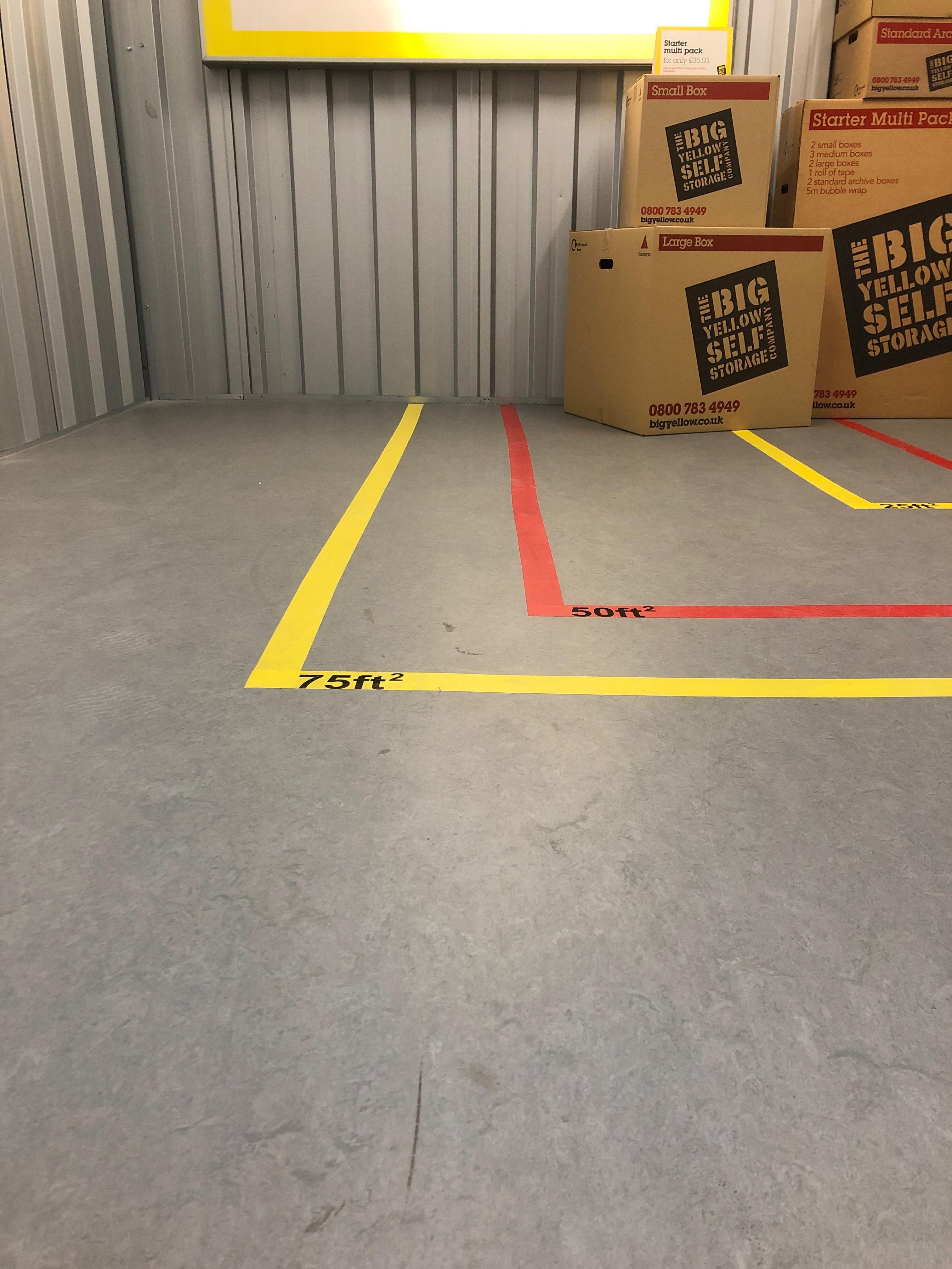

    We have been asked to lay out some markings onto a vinyled floor by our client. Now normally the floors are painted and the marked lines are also painted ( photo 1) but our client has decided, in their wisdom, to now re lay all of the demostation floors with vinyl flooring and needs theses markings replaced. Normal vinyl I am guessing would last about a week on the floor and any specialist floor vinyl would need printing and laminating at big cost for such a small amount being used. I have tried to use specailst floor marking tape but as it stretches when pulled from the roll it never seems to go down straight.
    I am thinking that a tape dispenser may help with a starighter line, is there a vinyl alternative or even paint?

    16 February 2020 at 05:59
    quote Phill Fenton:
    Rob’s bruv (Jim Lambie) is an artist who uses vinyl to create stunning visuals on floors with great success. So I don’t see why ordinary vinyls can’t be used to mark out floors in this way
    Phill’s correct…
    If the floor itself is a type of vinyl flooring, then you will not have a problem if you apply a decent brand of Polymeric Vinyl.
    The vinyl itself is tough when laid properly. By that I mean you must:
    * Sweep the floor
    * Wash the area which will be getting the lines.
    * Let it dry 100% (this can be sped up with a heat gun)
    * Apply the vinyl lines and if the floor is cold or the bond doesn’t feel just right, warm it over with a heat gun once it has been laid.
    Vinyl is not paint, it is not going to take the likes of a forklift truck wheel spinning around on-top of it, but it will easily handle people walking over it.
    You don’t want to apply long lengths of the vinyl or you will get twists in it and it will stick to itself.
    You do not want to tug on it, but lay it relaxed and it will not stretch.
    Cut the lines up the width of a 4ft wide roll. i.e. 48inches.
    If you are struggling to prevent stretching of the vinyl then apply an application tape on top and apply. But this shouldn’t be necessary once you get the knack of it.
    The following video is just a few of 60+ vinyl floor installations we have done for my brother Jim over the past 15 years, around the world.
    You will see the last one in Mexico had white vinyl laid first. this was just for easy removal of all the individual cut lines of vinyl and to make sure no residue was left behind. So a water-based adhesive on white vinyl was laid first. (Gallery was very specific)
    The vinyl we use varies depending on the floor type and stipulations of some Galleries but the majority is Oracal 751c or Oracal 551
    Not all, but the majority of these are installed on cold polished cement, marble or varnished wooden floors.
    This MASSIVE floor shown below was installed by us in Glasgow GOMA Gallery and in the 3 months it was down, it had a footfall of around 280,000 people in to see it and walk over it.
    I am not saying damage does not occur, it does. but obviously minimal or this type of work my brother does would not be possible and in many cases, installed permanently in places all over the world.
