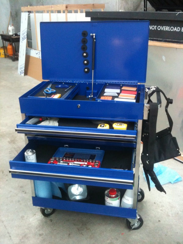

Posted by Jason Xuereb on 15 April 2011 at 05:53Just bought a new trolley.
Got that heat gun holster as well you can see on the bottom.
Need a few other bits and bobs but nearly happy with everything.
Anyone got any cool tools they use for wrapping?

great stuff nate… always good to keep everything organised.
have to ask though, do you apply the vinyl with the socket set? 😉
I’m guessing that’s to remove car parts and obstacles?3M primer, promoter?
wrapping gloves?
3M wrapping wheels, small + large?
knee pads?here’s a look inside my fitting box, you’ve probably seen before…

Hey Rob,
Don’t use primer 94. I fit mainly Avery.
Got my 3M Wheels and Avery seamless gloves they are in the draw.
Knees pads are for girls 😛
Have you seen the tools from yellotools.us?
I need a rollepro.
I’ve seen your tool box. This trolley is specifically vehicle wrapping. Doesn’t leave my factory 🙂
quote Jason Xuereb:Knees pads are for girls 😛
trust me mate, they are a god send after kneeling on a concrete floor for even 10 minutes.
I need to get another bit, but for a good while i had a cutting of thick carpet.
i used it to sit on, kneel on, mostly lie on… whilst doing the sill, bumpers etc so much cleaner and comfortable to work with. just slide it about as you move around the car.quote Jason Xuereb:I’ve seen your tool box. This trolley is specifically vehicle wrapping. Doesn’t leave my factoryknow what you mean mate, but best to keep "everything" vinyl fitting related
in one place. well thats my take on it… never know when bits and bobs will come in handy.The primer, promoter is 3M branded, granted… but to be honest mate, i use it "only" on certain recessed areas as and when i think needed.
i then use the heat, laser temp gauge. 3M wheels and so on… all simply to "do my up most to make sure they vinyl isnt coming out the recesses.about 18 months ago i had to replace part of an accident damaged wrapped van. when i arrived the bodyshop hade only stripped "half" of a full panel of the wrap material. and sprayed in only the damaged part! (idiots) 😕
