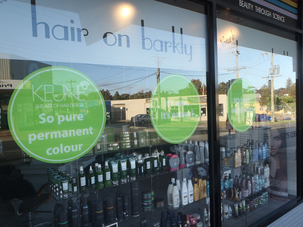

    Hi All,
    Today I fitted some vinyls to a hairdressers glass window from the inside looking out onto the street. As its the side with the adhesive on which is visable the vinyls ( 2 colours) didn’t look quite flat as it should. Its not wrinkled , maybe its a variance in pressure applied? Will the vinyl flatten over the next week or so? Or will it stay the same as when I fitted it?
    Vinyl used was Metamark M7. Should I have used a specific vinyl for doing this? This was the first time Ive fitted vinyl this way.
    Any comments/advice appreciated.

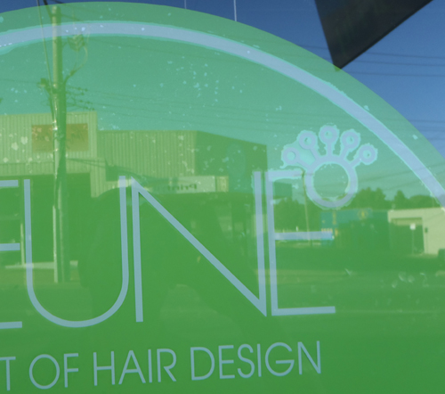

    As you can see from the attached images I had three green circles with white text. The white text went down first on the glass (inside looking out), then I put the green circles on behind the white. Problem is you can see where the green vinyl doesn’t touch the glass as the white text lift it away. Would the wet approach solve this? Also having a white circle already on the glass this would lock in liquid (if done wet) once the second layer goes down wouldn’t it?
  • Simon Worrall
    13 November 2012 at 08:48
    This is probably the only situation when I would apply vinyl wet. But even then, there will always be a "halo" where the white lifts the green from the glass.
    I would have reverse weeded the green, and backed up with a full circle of white, so the halo appears on the white. This way it is less visible.
  • Gary Birch
    13 November 2012 at 08:56
    How would any excess fluid escape from the the pockets though or am I missing something? That said we would have printed these.
    Was the squeegee in good condition? It doesn’t take much wear/damage to cause problems like this on glass.
    I can’t remember the last west application I did and personnally can’t see me doing one again.
    Dry is the way forward in my eyes.
  • Simon Worrall
    13 November 2012 at 09:08
    Gary you are right, printing would be better – green on clear, backed up with white. I’d have still applied it wet, though. I’m not that good with a squeegee to do this dry

  • Stuart Miller
    13 November 2012 at 10:09
    I don’t actually mind the thin line around the overlay. Its still there whether you do it dry or wet. I would have done it the same way around, rather than reverse weeding the green.
    Printing would avoid this thin border but is more likely to fade with time than cut vinyl so depends on expected life of the graphic.
    As for trapping water within the white circle: most will be pushed out during squeegeeing and if there is a small amount left a small puncture can be made into the lifted portion at the overlay edge to expel any excess.
    I use a soft window film squeegee (clear max) which conforms over the overlays better than a hard card.
