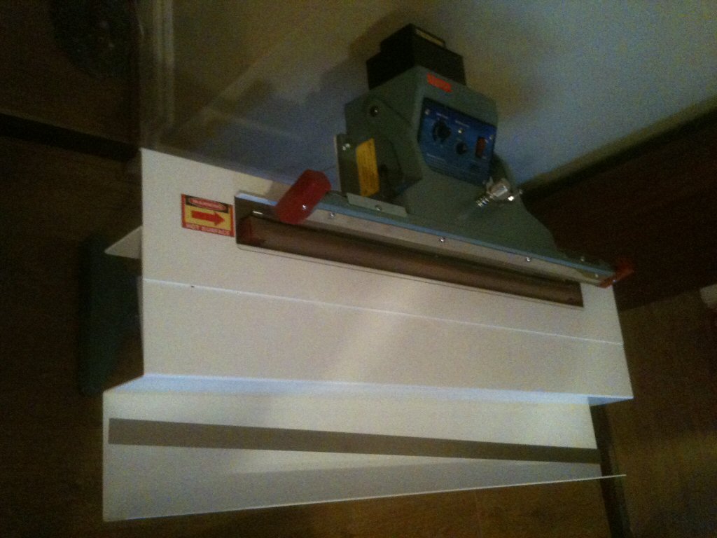

    Hi guys. I purchased the machine yesterday.
    Finally set it up this evening. Attached a photo.
    I have been trying it out on both laminated and coated banner. laminated banner tends to rip the material apart. The coated banner seems to weld much better.
    The heat settings are very tight, turn to 4 and it is not hot enough to weld, 5 tends to melt the banner.
    I will be playing with it to try and get things sorted as I have to print 6 x 6 meter banners over the weekend and need to get them finished Monday.
