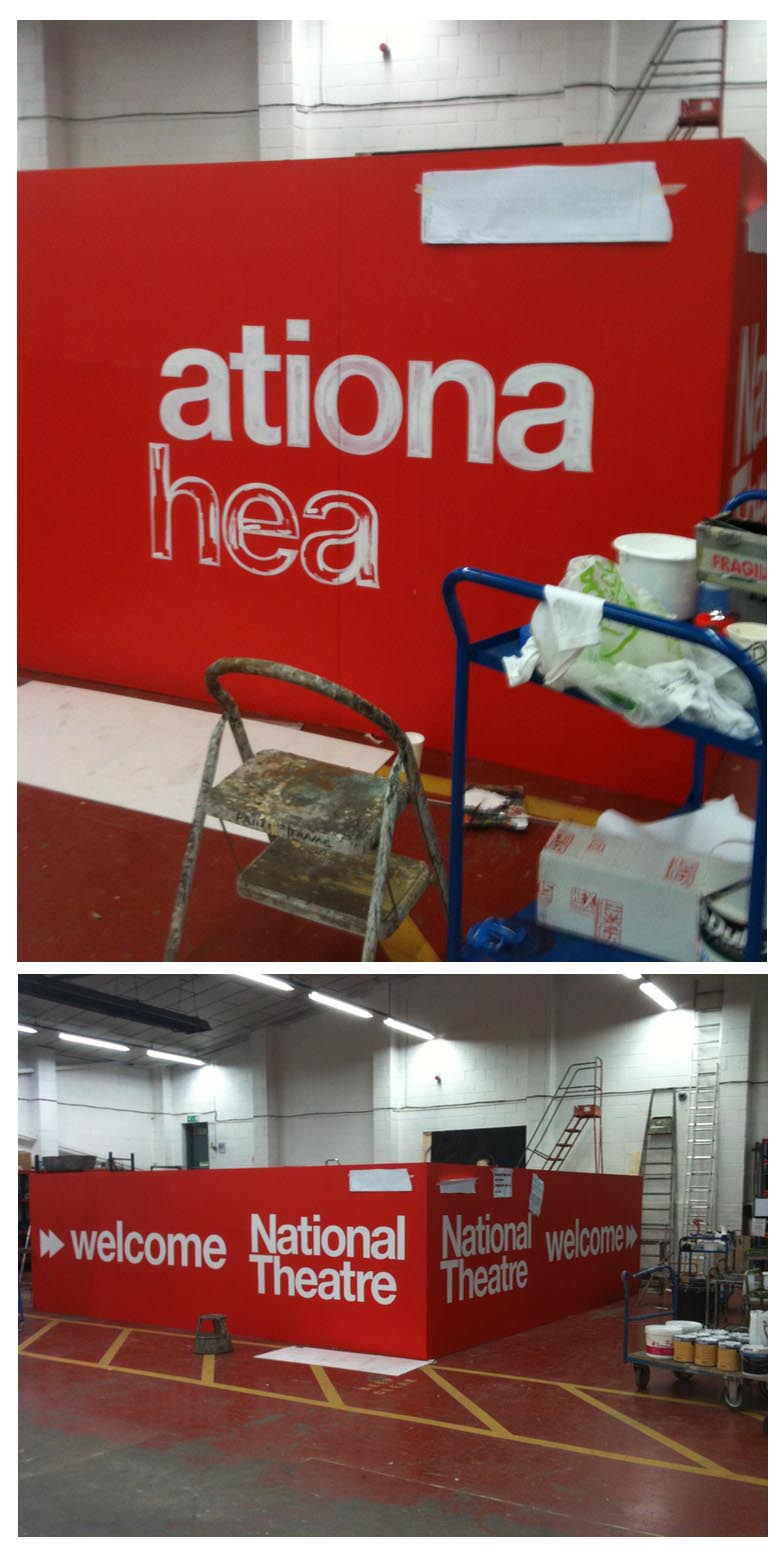

  • David Rogers
    8 March 2013 at 16:40
    Been there…done that.
    Gloss rollered hoardings are unsuitable for ANY small text.
    Got to ask…why 10mm? Is that just not stupidly small for a hoarding?
    All done in 3M 50 series…pretty sticky stuff, but still wouldn’t trust it down to 10mm if it’s rough painted and lumpy!
    http://www.uksignboards.com/download.php?id=19562
    http://www.uksignboards.com/download.php?id=26738
