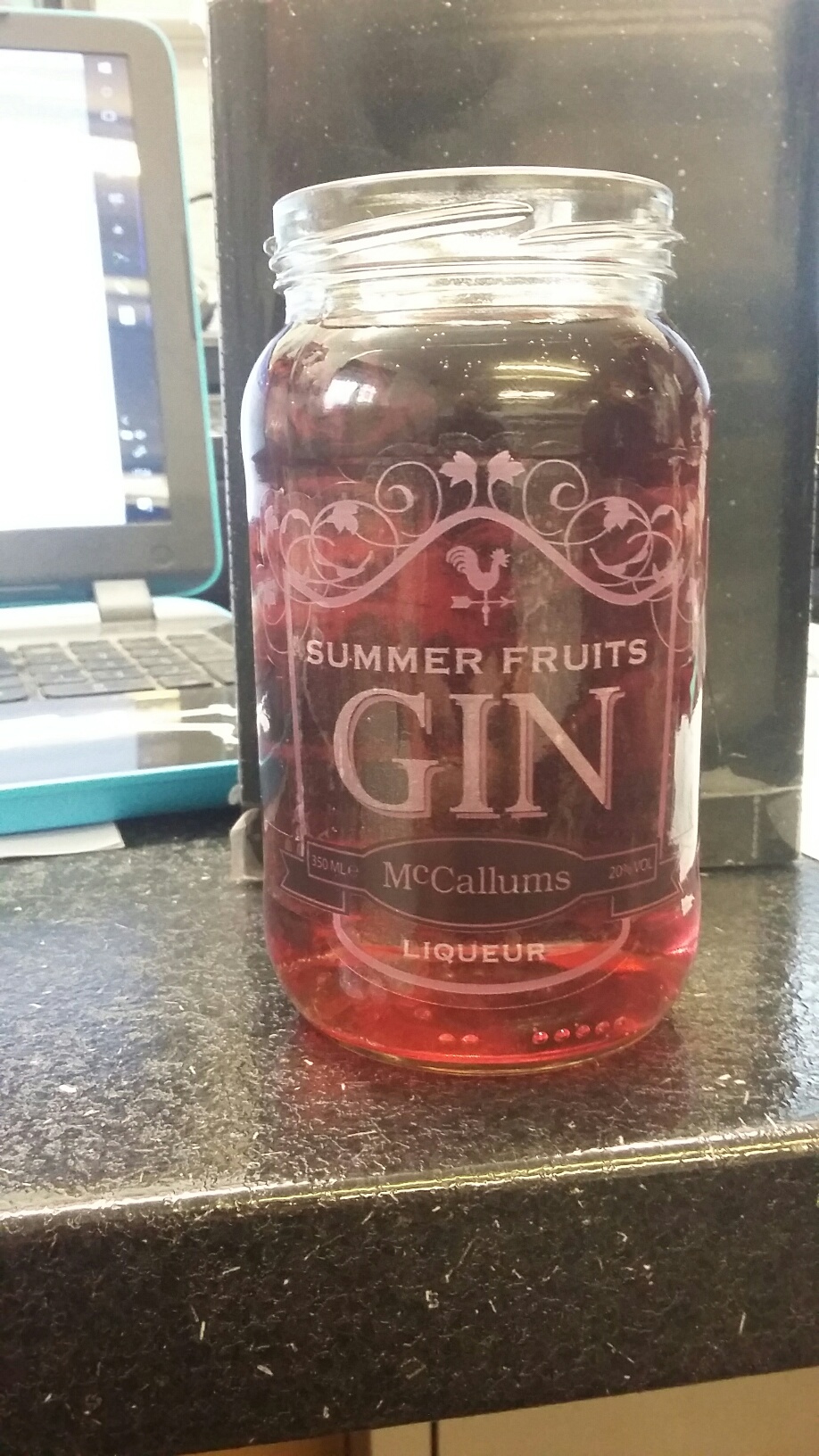

    Hi all. Can anybody help me?
    I am working on some bottle labels for a client. Printing on to MD3 clear, laying down white ink for a base layer, then the colour over the white or second layer of white where required on to the lettering sections.
    My issue is… the white is very transparent. I am trying to replicate a label which has been sourced from another supplier (which has "solid" white).
    For clarification, the SUMMER FRUITS, GIN and LIQUEUR should be solid white.
    Can anyone give me any pointers please, or am I expecting too much from the Roland EcoSol Max 2 white ink?
    I take the white cartridge out and shake it every day or two like the Roland tech advised me and I’ve done a test print and the white is present.
    I rarely use the white ink, but I’ve never been very satisfied with the results up to this point,
    I look forward to hearing from anyone with this experience.

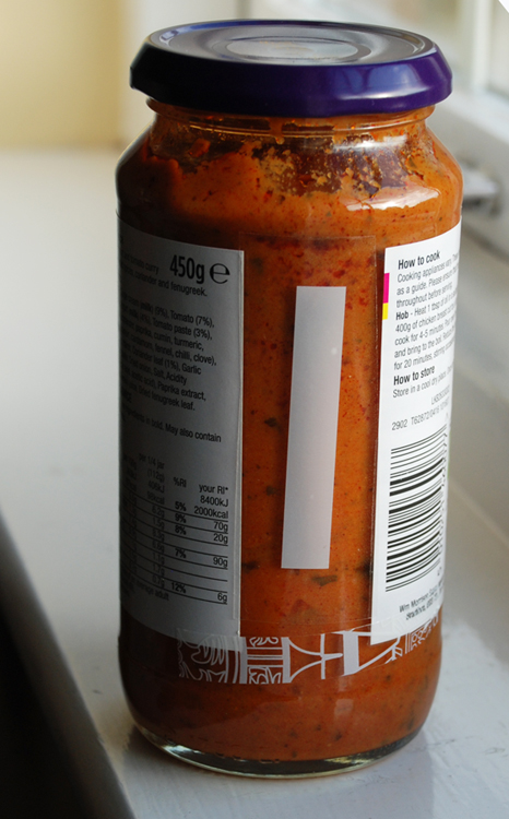

    ‘Tried to replicate the white sticker on a clear jar situation. (Tikka in this case)
    Here is a block of white I printed the other day on clear vinyl,(Roland BN-20) and below (the complex design) is part of the actual white sample I was given when I went to view the machine at Grafityp.
    There’s no difference between the two.
    Are these examples more opaque than your’s though?
    Chris could well be right.
  • Chris Wool
    8 September 2017 at 17:52
    just slapped this on a coffee jar was on cling film but should not alter the outcome
    chris w

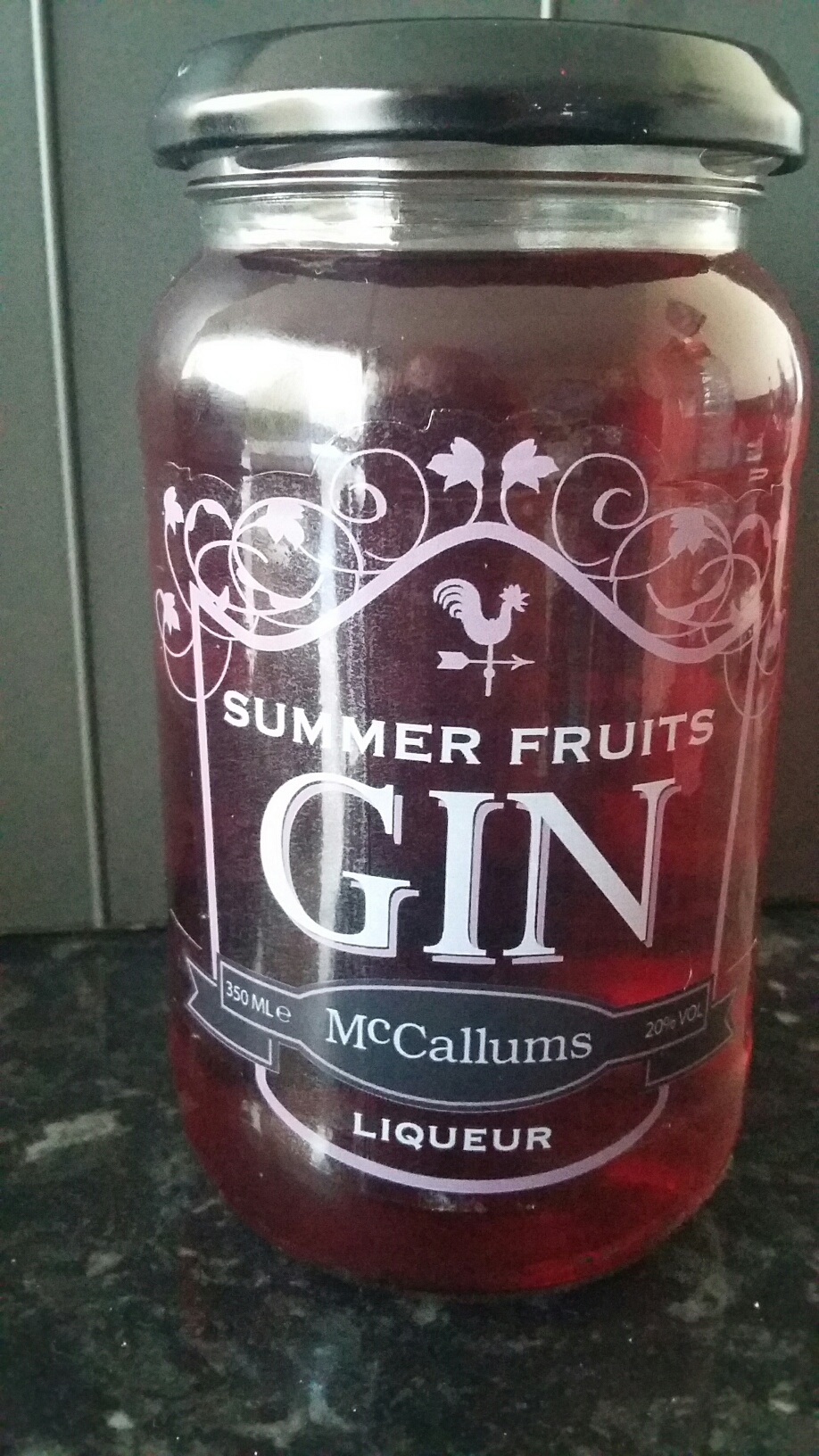

  • Gary Thornton
    9 September 2017 at 14:54
    Thanks for taking the time to reply and going the extra mile by posting pictures of what I should expect.
    I think because I rarely use the white, because I haven’t had the best results, the ink wasn’t particularly thick (if that’s the right word?)
    I shook the cartridge and carried out plenty of cleans and the ink seemed to thicken up; become more vibrant.
    I also turned up the white up to number 5 in versaworks , under the colour adjustment.
    Eventually after a bit of huffing and puffing I got this result, which I’m happy with.
    Can anyone tell me what cleaning/ maintenance process you do for your white ink. :thumbsup:

    Anyhow Gary, the 100% white part on your last print look fine.
  • Chris Wool
    9 September 2017 at 20:27
    That’s better well done
    . A few extra manual recirculation don’t go amiss
