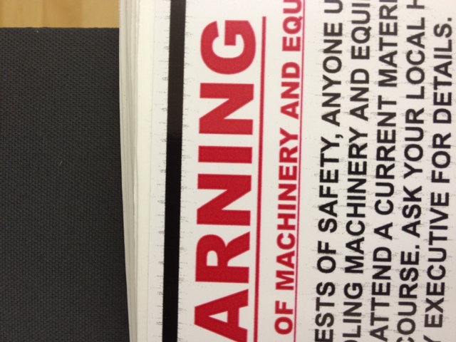

    Hi all
    i am having trouble with the black ink leaving dragging lines around the edge
    of the objects anyone had this before ?
    Thanks Neil

  • Neil Bainbridge
    12 September 2012 at 09:39
    Here is a photo of the bad print!
  • Dan Osterbery
    12 September 2012 at 09:53
    i would say you have fluff or fibers on the head and that is causing your problem! Have you looked at the heads? (see the other post to identify where the problem might lie, Karl posted a photo!) Do a manual clean and it should remove it! Could you also post a photo of a test print?
    cheers
    Dan

  • John Harding
    12 September 2012 at 16:18
    Neil I had exactly this problem although not quite as bad as yours the problem was fibres not exactly on the head but on one of the black plastic brackets either side of the head – a manual clean with the fluid and swabs sorted this 😀
    Ps i only discovered them when inspecting with my glasses on and using a torch 😀 😀
