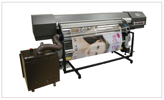

    I think a way round it is to have your printers located in a small partitioned clean room.
    it means the machines are in the right temp / environment, but in high production mode your in the next room out the way if the smell kicks up. plus a small extraction fan would suit better in a small dedicated print room.
    alternatively, there are extraction units available. i seen these a long time ago but cannot locate where!!!
    i have done a quick search and found the following. im sure some googling will find you something local.
    You also see large inline extraction units that sit directly above big printers. a bit like you get above a cooker!
    Also keep in mind how/where you dry your prints will create a high level of solvent fumes.
    http://www.purex.co.uk/news/newsview/31

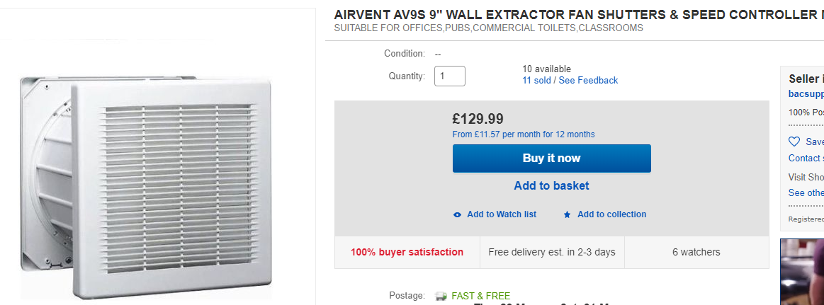

    I’m currently converting my garage to print room, insulated already and managed to get there radiator connected, but there is no windows and it isn’t enough airflow there even if open garage doors slightly up, which also isn’t ideal due to rain / dust etc. getting into room. I’m thinking about fan with automatic shutters like this one :
    Its got reversible controller, so can I use it to extract air and then pump in some fresh air, or i should install 2x (one in and one out) which should be on at same time? Also is that should be mounted above printer or under (behind) on wall where printed is located? Due to are intake option I’m afraid about dust to be collected from ground level… Just read that some recommend to install fans on floor level as solvents are heavier then air. Room is only 26m3, would 9" fan be enough? There is also 12" version but its a it too big whole needed for that.. I also thinking about something like IqAir Purifier. Is anyone use this, is got hepa filters as well so good for dust and carbon filter but I dont print that much and also wouldn’t spend there all day as computer desk and office got at home, where I designing etc.. Just want to be safe, I know most dont even bother about ventilation using eco solvents but I’m got some worries and wish to have any advice please. Any other solutions? Was thinking about windows but cant find right size..

    Ive seen this diagram but it isn’t specified it is for solvent or ecosolvent as there is a bit difference regarding health hazards isnt? Am i should use 2 fans then, as i must say reversible would be more convenient as I would have to drill two holes.. It would still exchange air in room in my opinion, or it has to be in and out at the same time? Any wall mounted fans recommendations? Also should it be ATEX explosion proof certified fan or any fan would do the job?
    Also what is mean 5-10 air exchanges per hour and how to calculate air flow needs for my room – 5 x 2,5 x 2.10m – 26m3? Fan from link got 259 litres/sec, is that enough if we count 30min pump out air 30min pump in air per hour? Or i should give up 2in1 fan and install 2 separate and if so any recommendations? I found only this decent size wall mounted with auto shutters..

    Fan from link got 259 litres/sec,.
    More likely 259 l/min, at 259l/s it would be either a vacuum in the room when sucking or a hurricane when blowing, plus it’d probably sound like a jet engine on full pelt.
    As for the room, 5 air changes per hour is 26.25 x 5 = 131.25m3 per hour = 131250 l of air, divide by 60 to get into minutes = 2188 l/min,
    I found a website that do just fans, that have a 9" through wall fan for around £110-140 that should be suitable and quiet

    Thanks for reply. Well, I’ve double check and spec for fan from link is:
    Extract Performance:
    "Low: 680 cubic metres per hour/189 litres per second
    High: 1015 cubic metres per hour/282 litres per second
    Fan Speed: 1205 – 1915 rpm
    Noise Level: 52 dBA
    DIMENSIONS:
    Front Elevation/Grille: Approx 340mm square"
    Not sure us 52dba on low or high but I think performance is pretty good. I’m refering to this on as its only one I found which is ip44 with automatic shuters both sides and got controller for speed and reverse. They cost 140£. Any other types recommendations? From calculations above i think 6" fans would also met needs am I right? Also what about suggestions about air purifiers/ scrubbers? Wpuld that iqair 250 would be any good to replace extraction fan?
