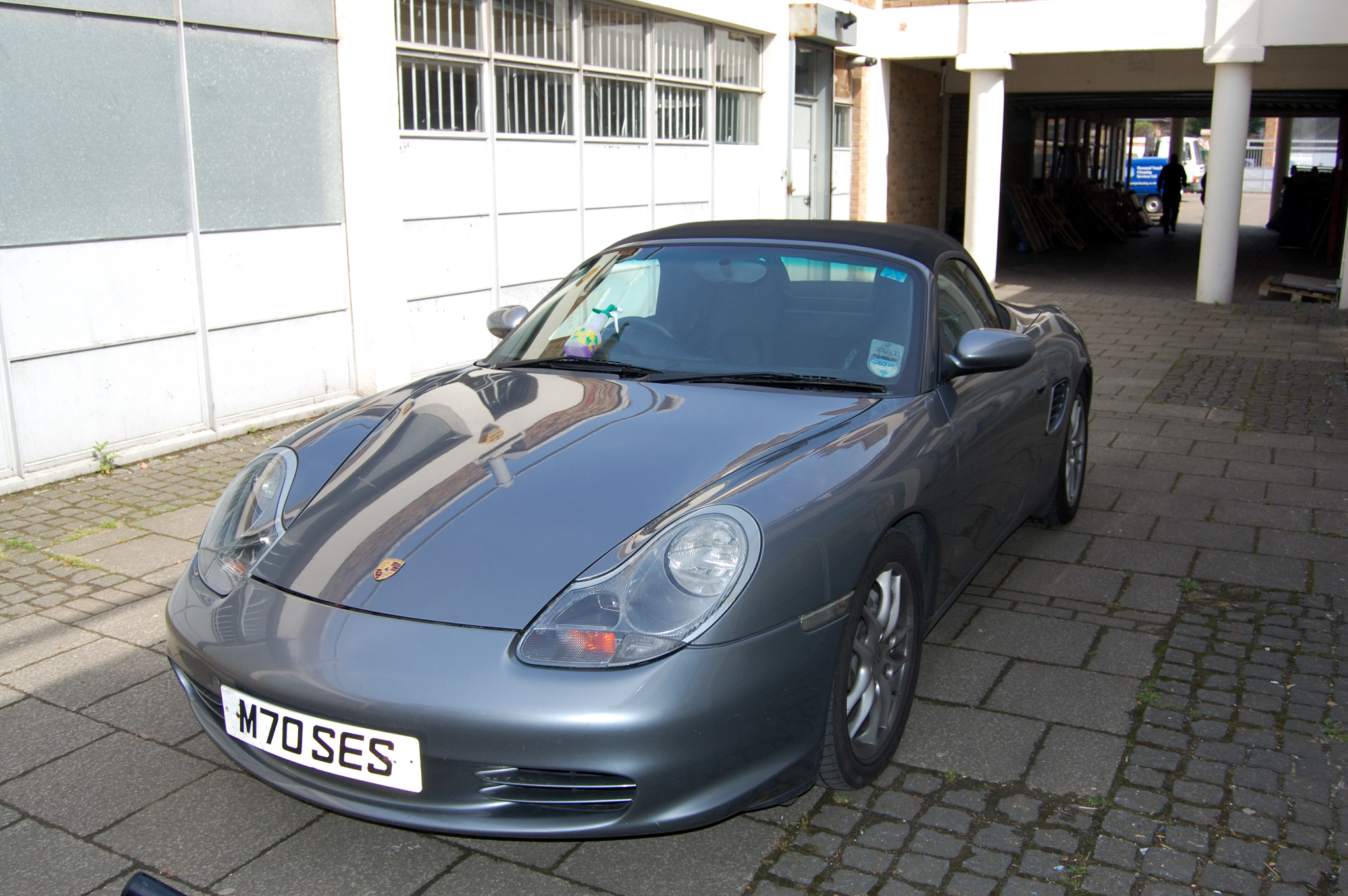

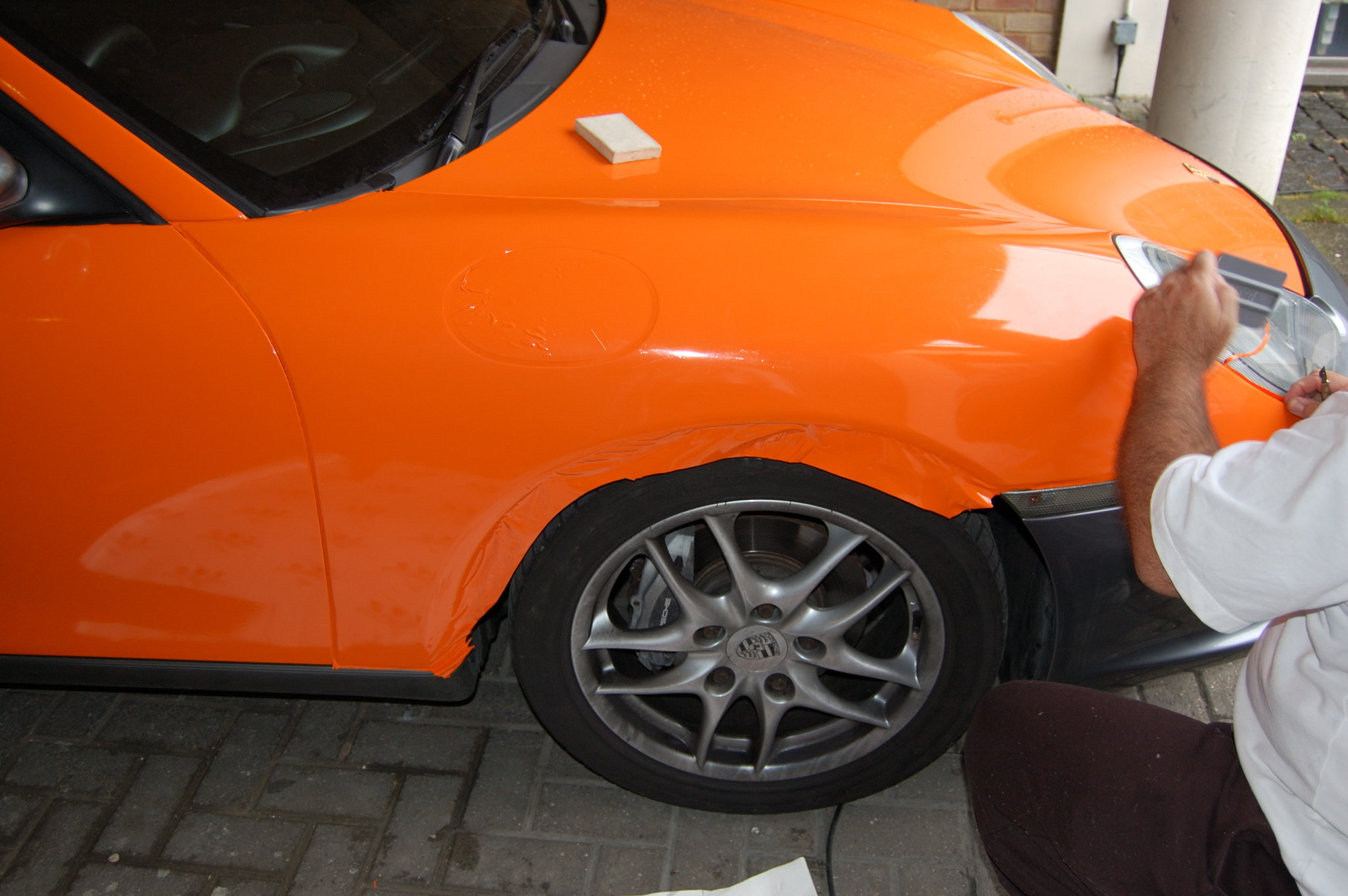

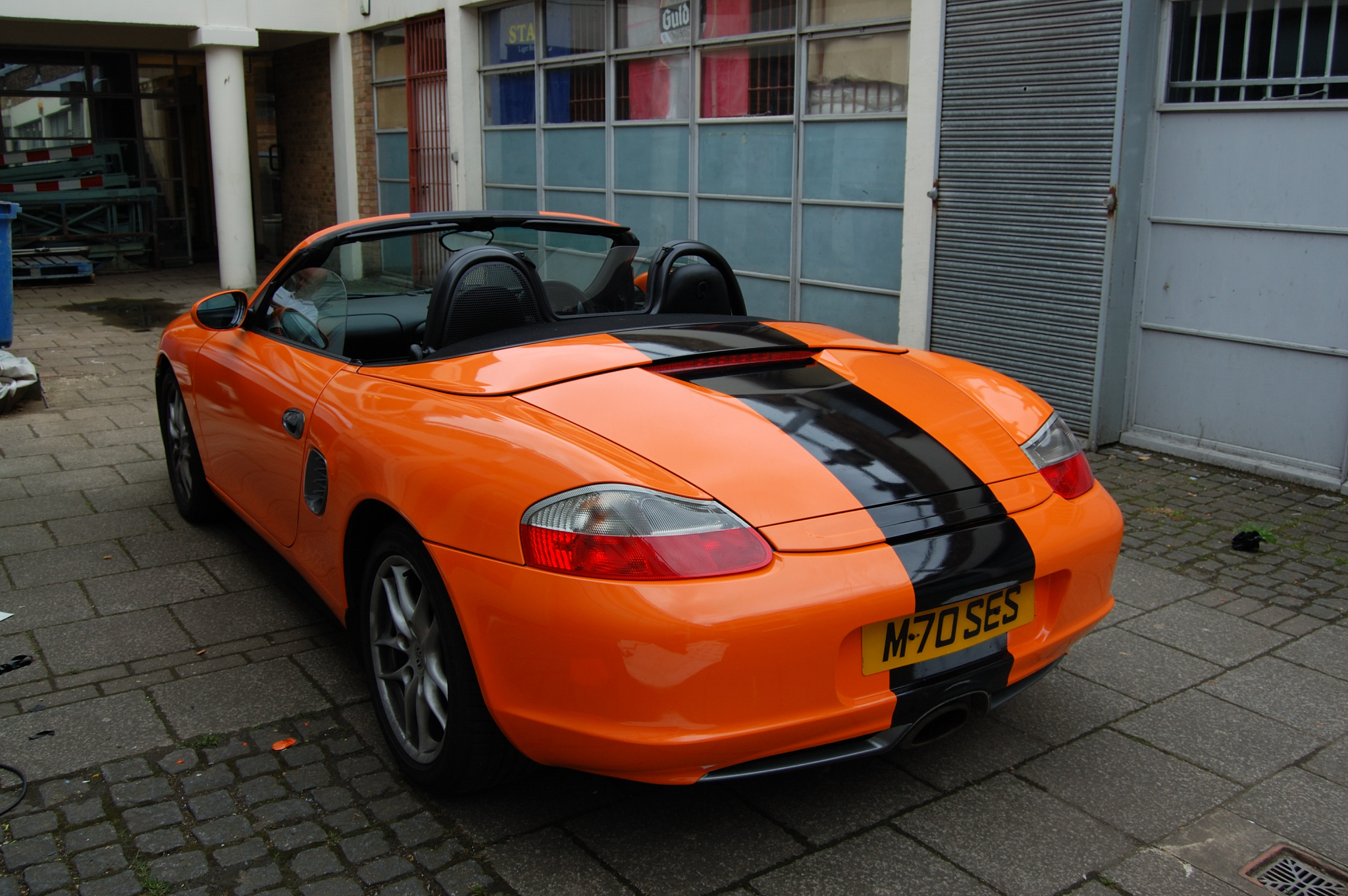

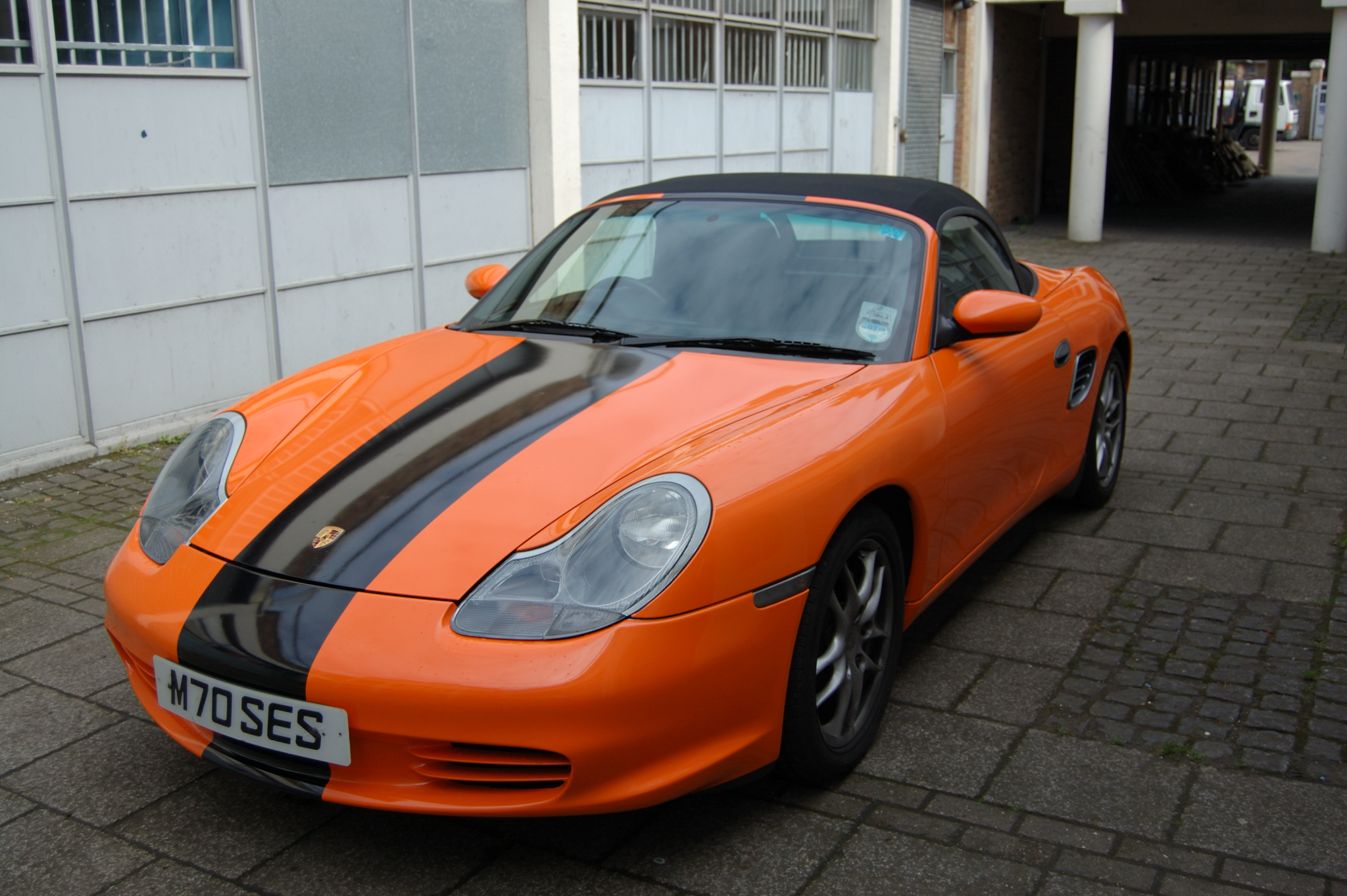

    Hi All
    Do not get time to post on here very often but i thought this one deserved a bit of an outing.
    Let me know what you think… good or bad..lol

    Thats a good job, what material did you use?
    and did you need to "patch" the front bumper, looks very difficult around the grills to do .

    The only vinyl we could use was purchased from Hexis. part of their KPMF range (Many thanks to Mark Monksfield of Hexis for all his running about with samples). All the other samples we tried lost opacity when stretched over the front & rear wings and you could see the silver through the vinyl. We patched in the front grill area and the rear number plate section as I did not want them pulling out. Other than that 3 days of hard work really paid off. Customer was over the moon and went of with a handful of business cards.

    Great Job Alex

    looks great in that colour

    I understand what you are saying about wrapping and the prices people charge but I find this type of work quite a challenge to my skills and am happy to charge good money for what gives the customer a great end result. If I was charging for this as a 1 off I would want between £1500-£2000+VAT. The owner got a price of over £3500 to respray orange and when he finished his promotional work in a couple of years would need to pay the same again to have it back to silver this worked out reasonably cheap for him. Although for me it was not bad for 3 days work baring in mind the KPMF material was not like buying a Wrapping film & Laminate which would need to be charged extra for. I just wish someone would let me loose with my digital printer on their car..lol
