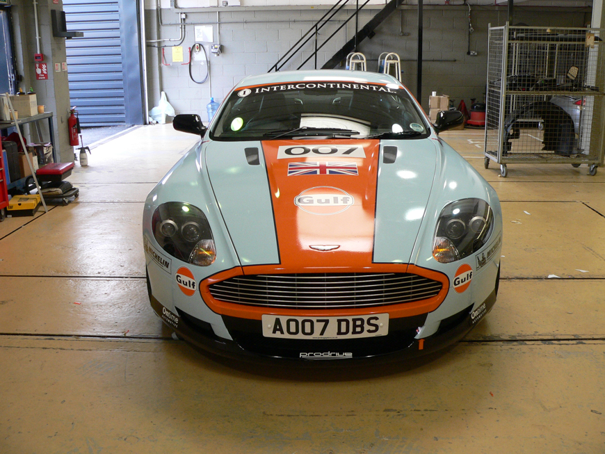

    This was basically a colour change , the car was black to start with Printed the blue on Graphiwrap. system
    A replica of this years Le mans car.
    Number plate is real to
    James Deacon helped out with the fitting, in fact he did most of the blue,

    Nik, the fitting time was spread over 3 days, because of hold ups and unforeseen circumstances.
    But the actual man hours was about 16. + about another 10 hours measuring, and recreating the design, plus cutting and printing
    so in all I would say 30 hours total

    Thanks for the comments.
    I could not find a pale enough pigmented vinyl that was also suitable for wrapping, and the client was happy with
    The orange was indeed laid down after, it would have been difficult to get the straight lines otherwise.

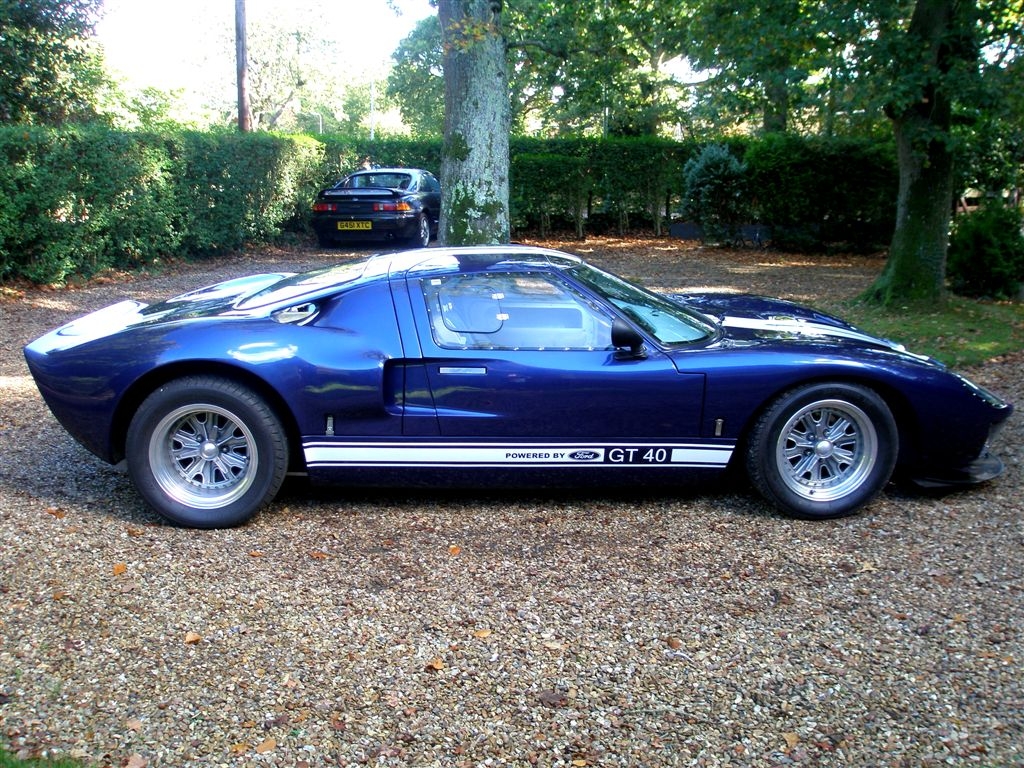

    OK, I won’t mention the car but my mate owns this…
    Thats not a proper, sorry cant mention the name, this is 😉

    looks spot on Peter was it hard to apply the orange around the the grill? Do you have any tips?
    David, Because the wrap was already in place, I just over sized the top half of the orange, and cut to shape with a scalpel, the blue pinstripe was then applied which covered any wobbles that i may have had,
    The bottom half was applied as a strip and just worked out from the leading edge, with a litttle heat
    Ha ha. This was built by Ford with a 370BHO 302 cu in lump.
    It would need a proper circa £40,000 to own this "improper" motor though.

    Rich, very little was removed, rear light clusters, repeater lights and the grills on the front wings and bonnet, only other bit, chrome trim on wndow bottom rubber.
    Oh, badges as well but not a lot else as the car is pretty smooth all round

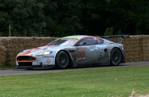

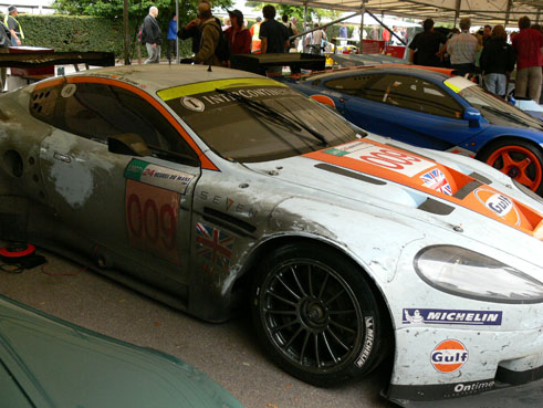

    A couple of pictures from Goodwood this month where this years Le Mans winning works Aston DBR9 GT1 was on show complete with all the dirt from the race.
    009 won it’s class by less than 5 minutes after 24 hours of racing. The sister car 007, which Peter’s customer car emulates finished 4th in class.
    If you think the car looks beautiful – you should hear one!
