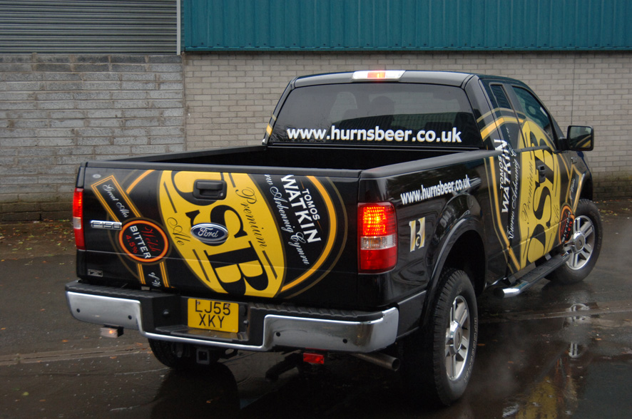

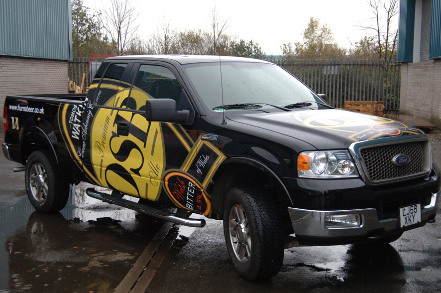

    hey everyone , just thought id show you my first attempt of a vehicle rap , things went out , just think i need to learn how to finish off to a better standard , around the windows etc, just need a bit of practice i guess lol
    i did the van in the bk ground too lol
    any comments welcome
    Ben 🙂

    nothing wrong with that Ben, well done.
    as long as you learn by each application, you can’t go wrong.
    cheers and thanks for sharing

    looks fine to me ben,
    only slight worry, will the police be happy that the front windows are partially obscure? even with contravision?

    looks good to me too !
    not sure the windows will be a prob, unless you’re a midget, sorry, vertically challenged, i dont think you’ll have any bther seeing over them ?

    Looks great Ben, really like it. 😀 You did well for your first time too!

    pick-up looks really good for a first go mate. well done!
    what vinyl did you use?
    did you apply it wet or dry?
    what areas gave you most bother?
    thanks for taking the time to show us your work. 😀

    Thanks :lol1: I used orajet 870 cast vinyl. It was quite hard dry so I went for the wet option lol. You sent me some special spray, I tried to contact you but had no luck. so just used soapy water ??? is that right ?? it went on pretty well as most pannels were flat and large so there were no BIG problem areas, only part I would of liked to improve is around the windows, the cutting out part I find the hardest 😕
    Any tips ? or how to use that spray ???
