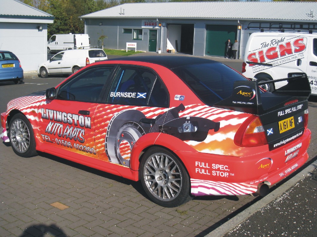

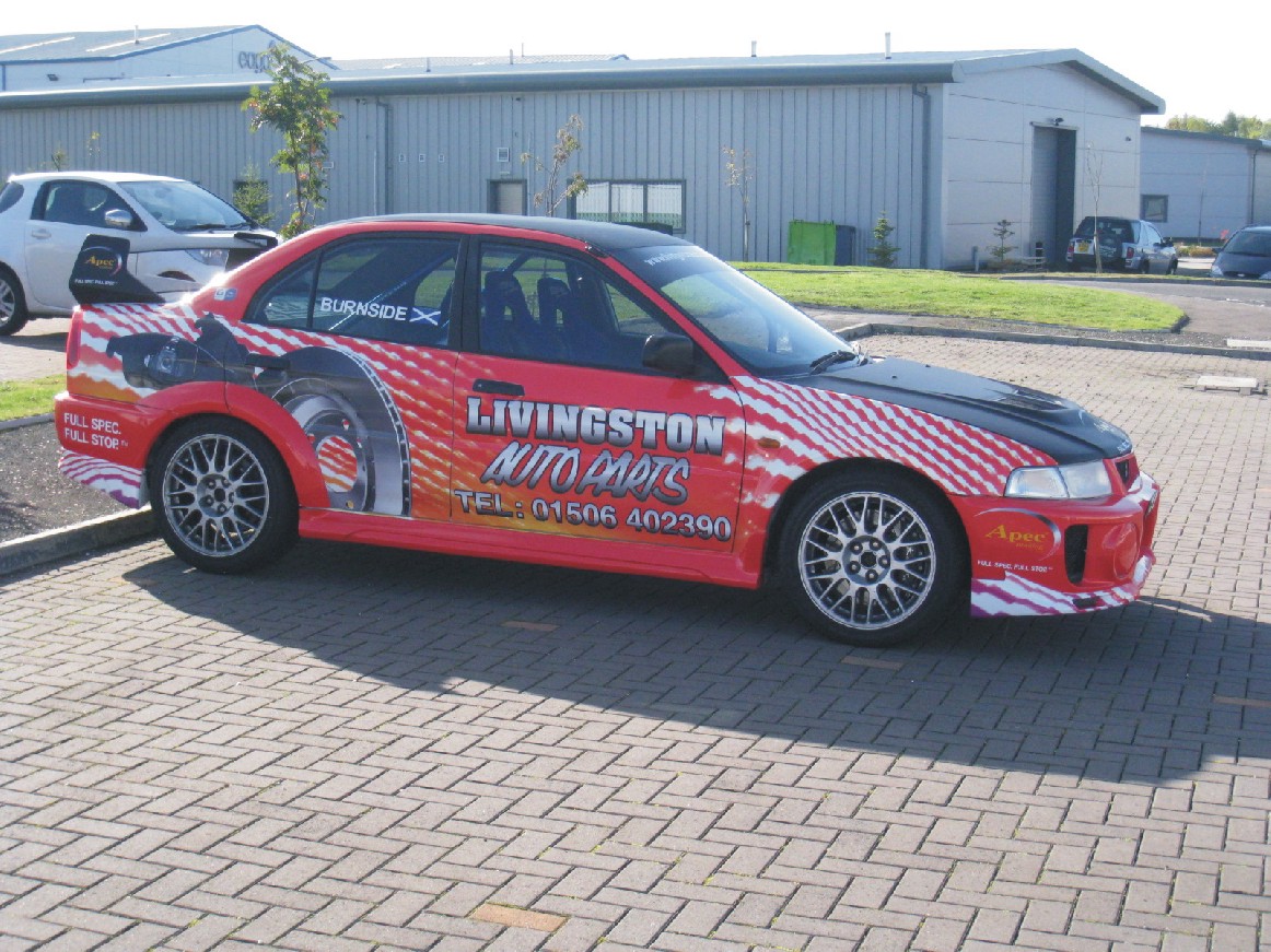

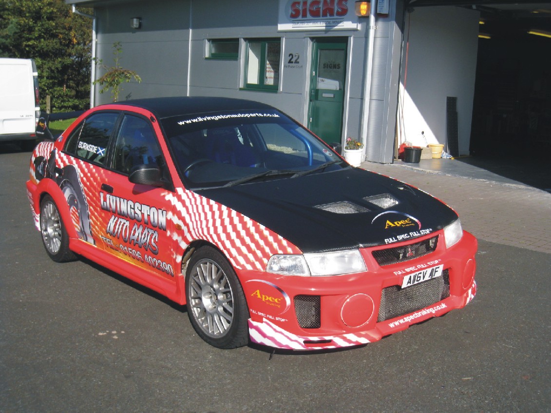

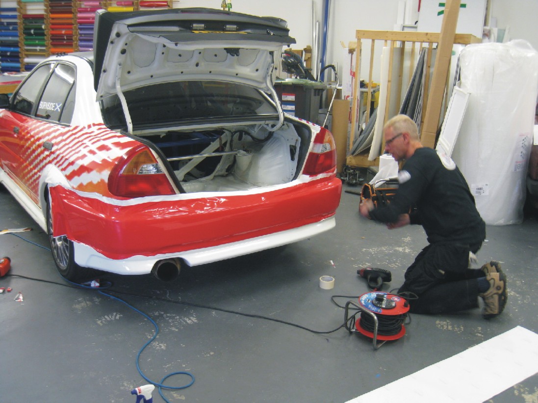

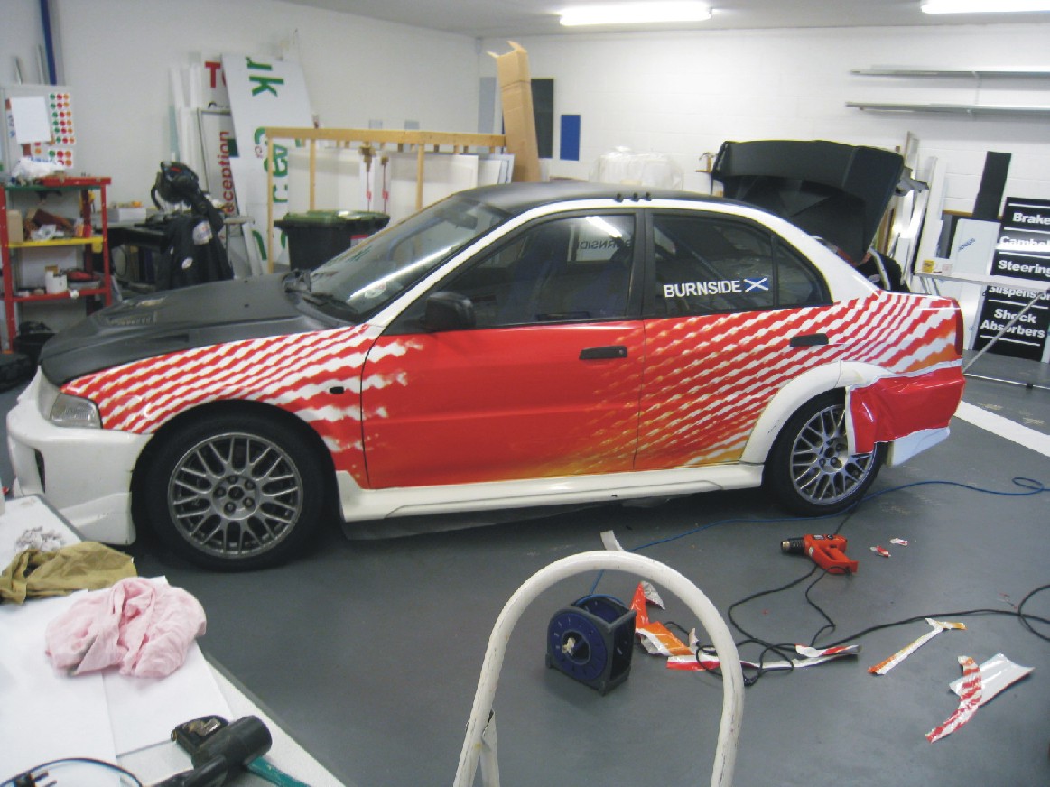

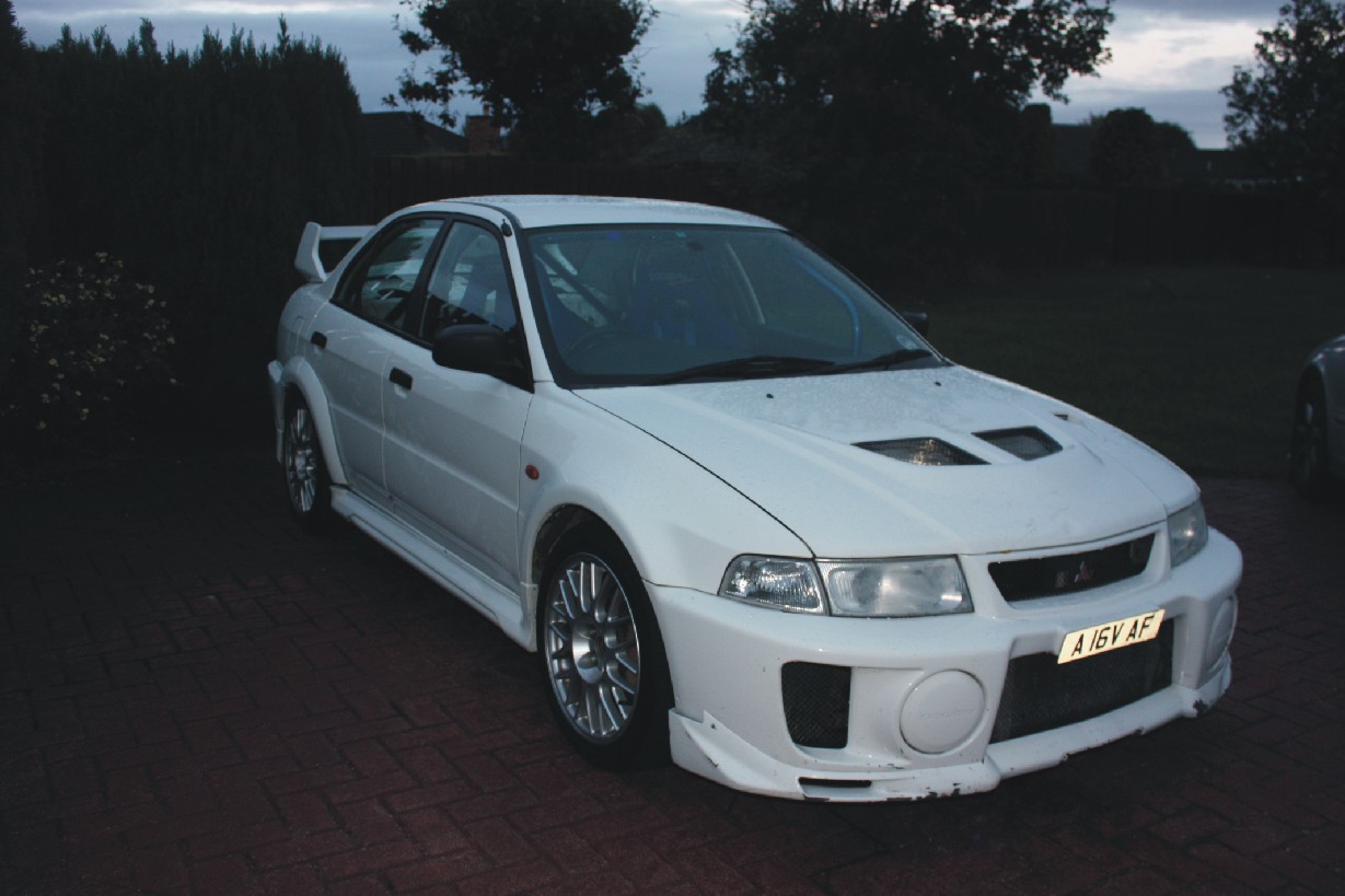

    When I was first asked to do this job, I realised I was probably biting off more than I could chew. I therefore decided to call on the help of Ewan Roberts (who is a highly experienced wrapper) to help me out of my predicament. I soon discovered that the work he does is amazing. He is an absolute gentleman. Very patient and calm.

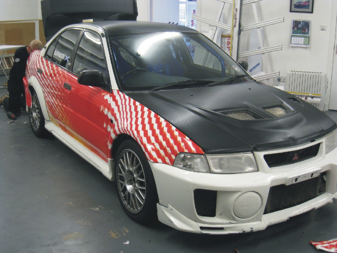

    The roof, bonnet and rear spoiler is all carbon fibre. The rest was done using Oracal 3951 print wrapping vinyl with it’s corresponding clear laminate
    Anyway – here’s the end result

    gets my vote and suits the company business
    proper job i am not going to nitpick

    Looks mint mate, what carbon vinyl did you use and how did u find it?

    I will concur with the learned Lord Wool.
    nice job Phill, did you do the design?

    Gareth – this was the Oracle carbon wrap vinyl that we used. This stuff was easily torn and Ewan commented that he preferred using the APA version. I’ve never used any carbon effect vinyl before so have nothing to compare it to. Though it did apply easily due to the glue texture which allows the air to escape.
    Peter – the design was done for me – I was sent the artwork to use though I did recreate the chrome effect lettering as the original design had a soft shadow, and I wanted to apply all the branding seperately on top of the wrap to ensure it was level and undistorted.

    I wondered if you had done that Phill you can’t tell from the pic’s (well I can’t)

    Great job Phil and i agree with your comments on Ewan. Nothing is too much trouble for him and i`m always very impressed by his work.

    Top looking job, Ewan has done a few bits for us on rally cars up in Scotland, always of a high quality! nice work! 🙂

    Looking good!!
