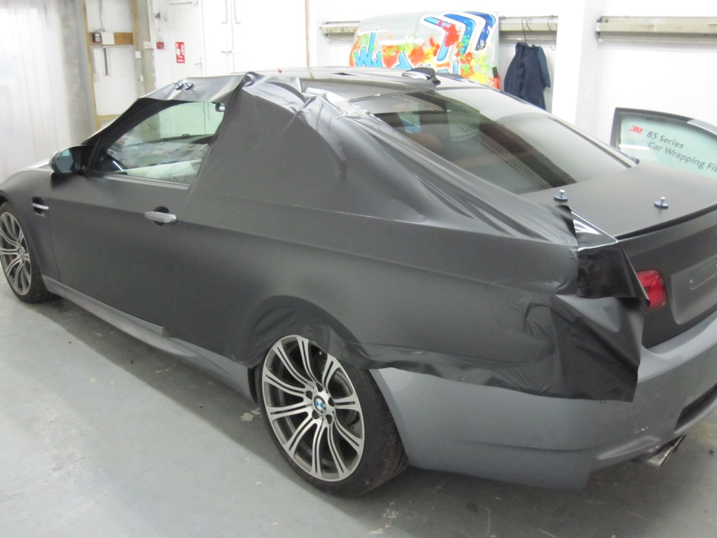

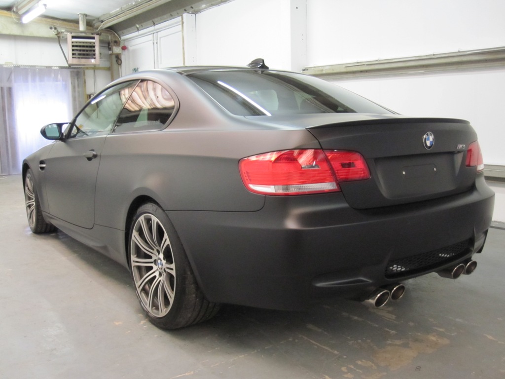

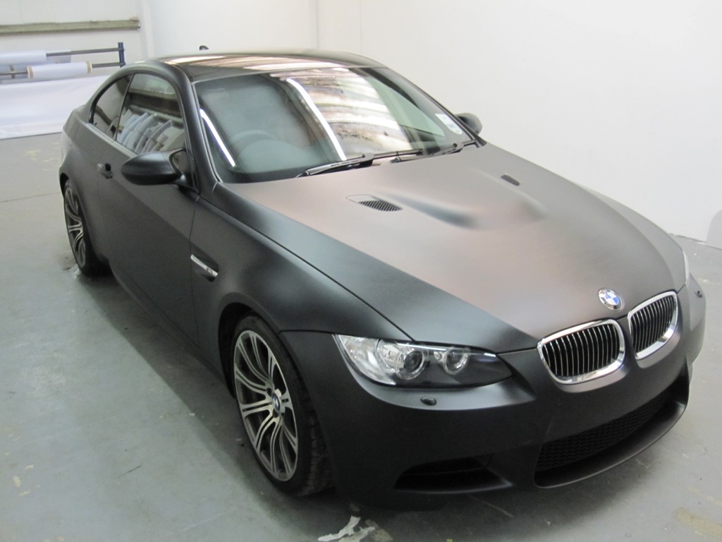

    Wrapped in 3M 85 series vinyl. Car took 11 hours to complete, the roof was not wrapped as it is genuine carbon fibre!
    Any questions, comments or even constructive criticism welcomed!!

    Hi Andrew, looks good. How did you find the 3M material? I understand it’s not a cast, was it ok on the bumpers?
  • Andrew Gamble
    11 February 2010 at 17:14

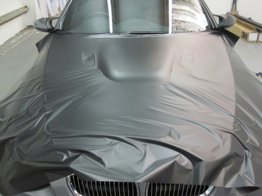

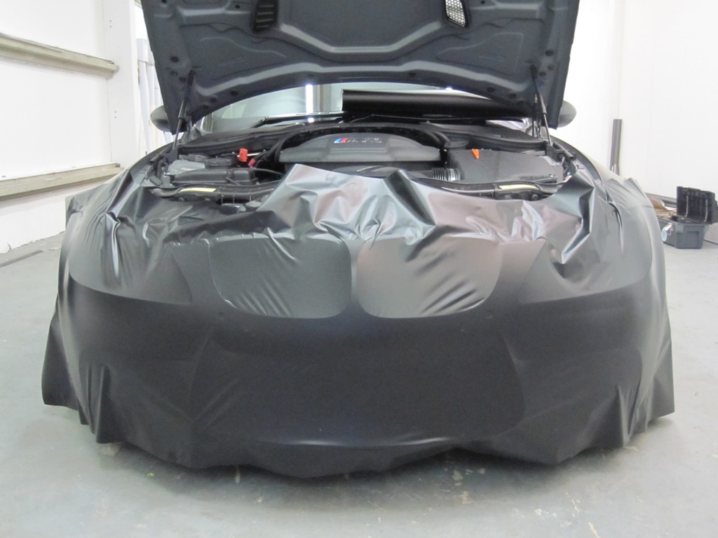

    Thanks Jon, I personally find this the best material to use, the bumpers caused no problems, the only thing required is gentle heat and not get carried away with stretching to avoid matt becoming gloss, which is a problem i’ve found more on other matt black films.

    as you mentioned, matt tends to gloss when over stretched. im guessing you have "peiced-in" in areas like "underside of headlights" and the like?
    or was there enough give to do this without it glossing?

    Rob, apologies for the delayed response…busy day! There wasn’t any need to piece in on this one, there was enough material to drop in without glossing on the bumpers….I personally find the 85 series is far more forgiving in these areas and seems to have a far greater tolerance than other matt films i’ve used.
    The other thing often mentioned is that this film is more of a satin black than matt, which I prefer too, as it is far more resilient to marks than the really matt films!

    Hi Phil, The material is 3M Scotchcal Car Wrap Film 85 series matt black, product code SC85-2097 CW, sourced from William Smiths.
    You can get it to ‘gloss’ with too much heat and/or overstretching but as mentioned I personally find this film very user friendly and don’t encounter any problems with it.

    did you leave the lights & trim fitted and just cut around them,
    I dose look like a very nice job that has been done.

    To answer your question Paul, yes, thats exactly what we did. Nothing was removed from the car other than the M3 badge on the bootlid, which was carefully put back using vhb tape! The lights, indicators & door handles were all carefully cut to the outer edge and of panels, with the excess material then just applied with the hard edge of the squeegee and heated in.
    I tend to remove what I can from vans/commercial vehicles, their ‘agricultural’ nature means nuts/bolts are easily removed… cars i only remove what I feel comfortable with…. and I didnt feel too comfortable taking a 50K motor to bits in all honesty!
    If there was a remote chance of any original colour showing though I use a mechanic that resides close to our bay to strip things down.
