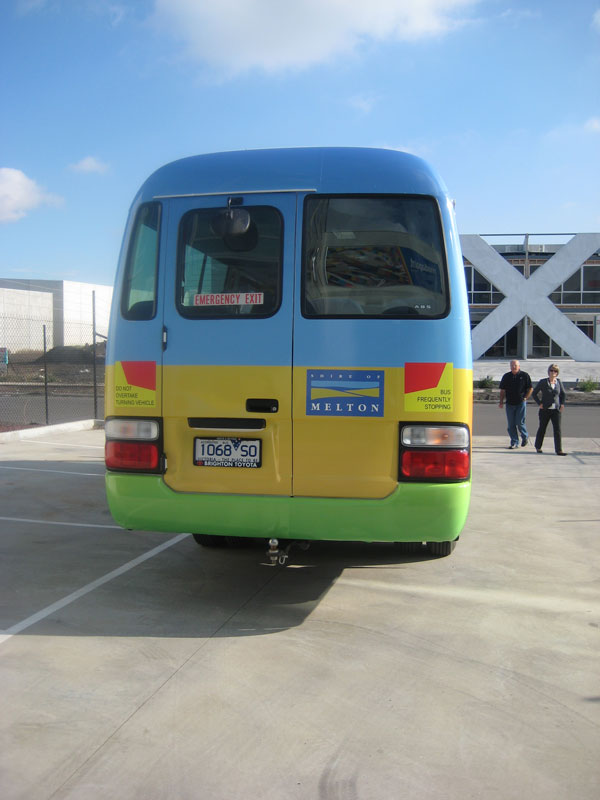

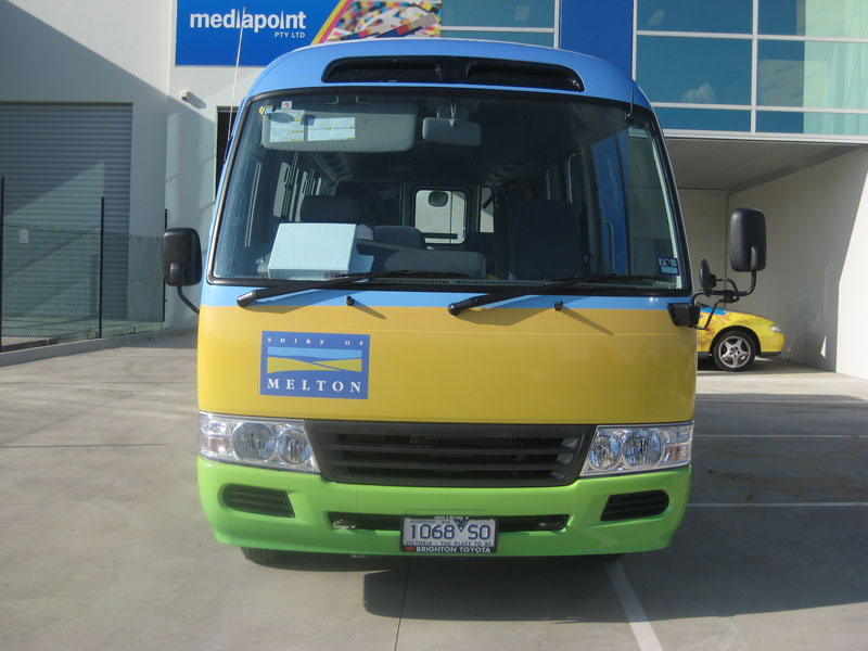

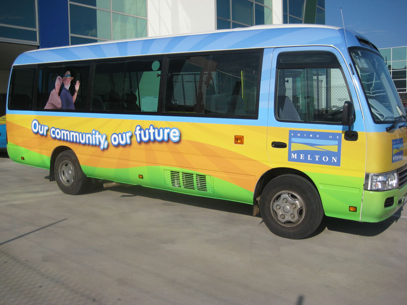

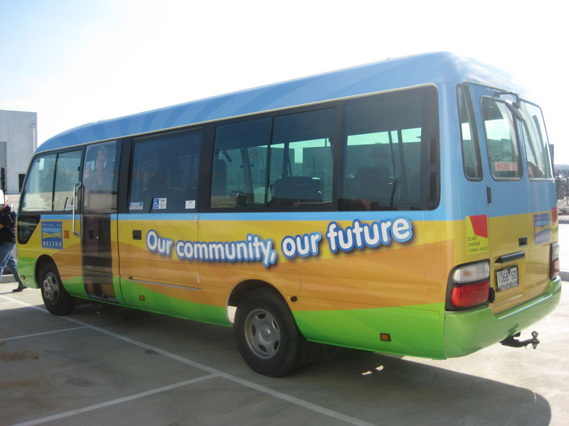

    Knocked this out over the weekend.
    I’m starting to get a bit better at this sort of stuff.
    Enjoy.

    Nice job mate. I like the idea of the 2 passengers at the window waving.
