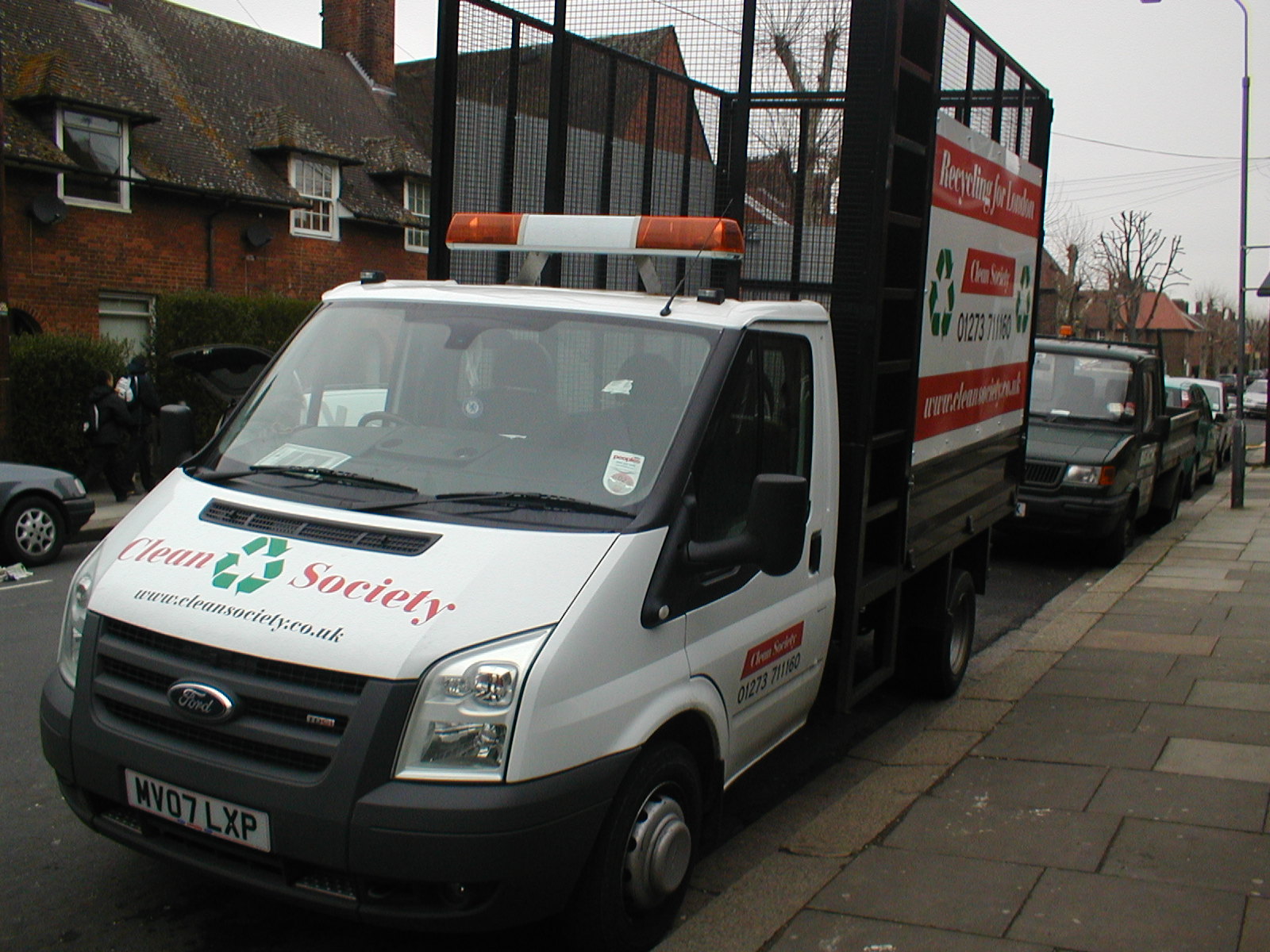

    looks pretty tidy John,

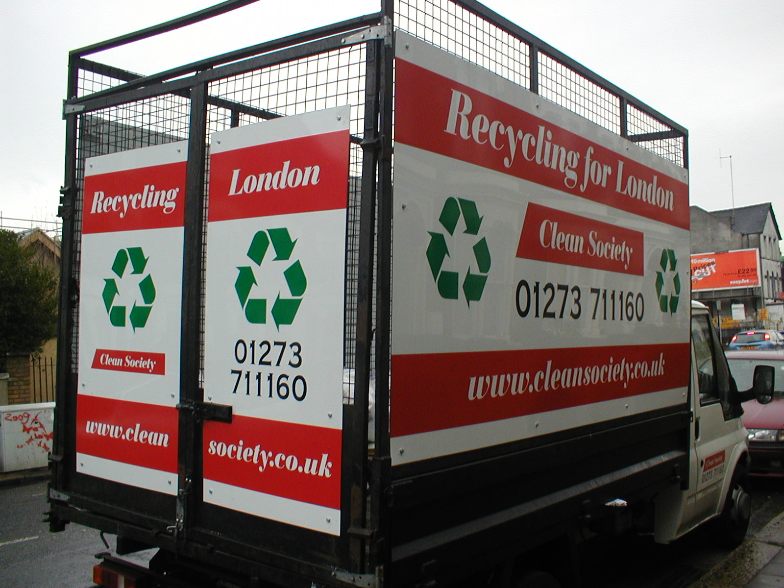

    is it dibond ? and how did you fit it to the mesh ? i got a similar job coming up soon (signs on heavy security fencing) so was just wondering !
    where are you based then ? i see it’s a ‘London’ truck, but with a newhaven/ lewes / brighton / shoreham area code !!
  • John Harding
    1 April 2007 at 21:56
    Hi Hugh
    Yes dibond panels either bolted through frame or fixed to mesh with plates on reverse and foamex packing peices in between, I guess the office is out of town your way less overheads etc, but the fitting ive done is all over london.
