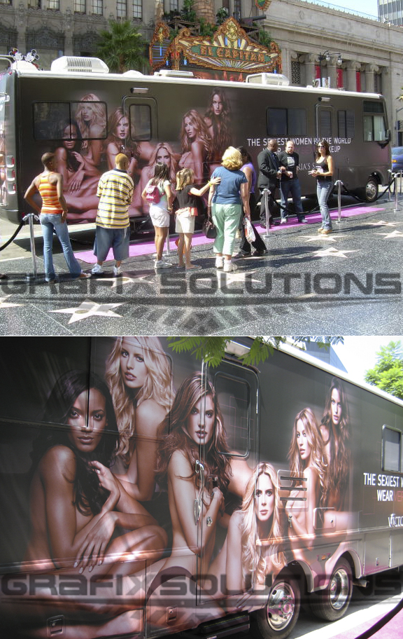

    This wrap proved to be a very difficult installation. The weather outside would not cooperate, there was no indoor facility, and the fiberglass surface had just been acid washed so everything wanted to stick and stay stuck. This was printed on Avery’s MPI1007 EZ product for a matte finish. The pictures do not do justice for this wrap. It looks like a flat black finish on and old school hot-rod. The windows were printed on Avery MPI4002 with a high-density output so the images did not appear washed out.

    Good one George. Impressive.
    And much nicer than some of the images we get to work with here. 😀
    28 November 2006 at 06:32
    well done George.
    How many guys helped with the installation?
    Looks like one of the satisfying jobs that you can look back on and enjoy.
  • George Kern
    28 November 2006 at 06:42
    I must admit, this one was notttt too hard on the eyes :lol1: I wish I had pictures of the rear of it but our install team was having a problem with the camera and the pictures they took on their cell phones just were not worth it. The rear was my favorite part because it had the group of the models and on the bottom the Victorias Secret lips logo printed on white reflective, looked absolutely incredible.
    This install was done by a 3 man crew, one on top of the scafolding setting the panels, one on the ground lining up the panels, and one doing all the finishing work such as rivets, bubbles, trimming edges etc. Installation had to be done over a period of 2 days and a total of 17 hours =O There were also sections that could not be shown because of the camera problems, but the entire RV expanded on both sides and the popout sections were also wrapped as well. 5 and 7 exterior compartments, lots of detail work when it came to finishing.
