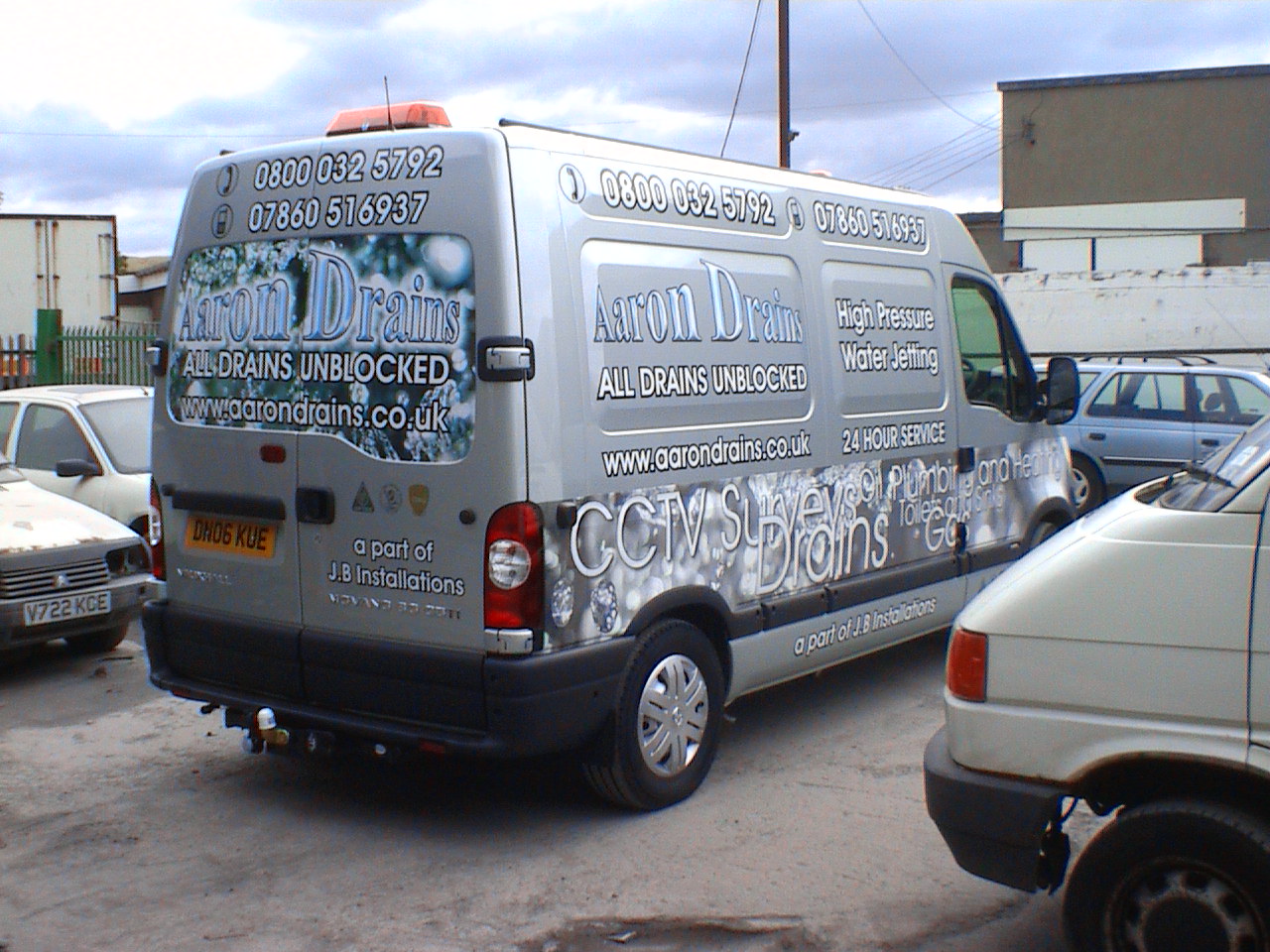

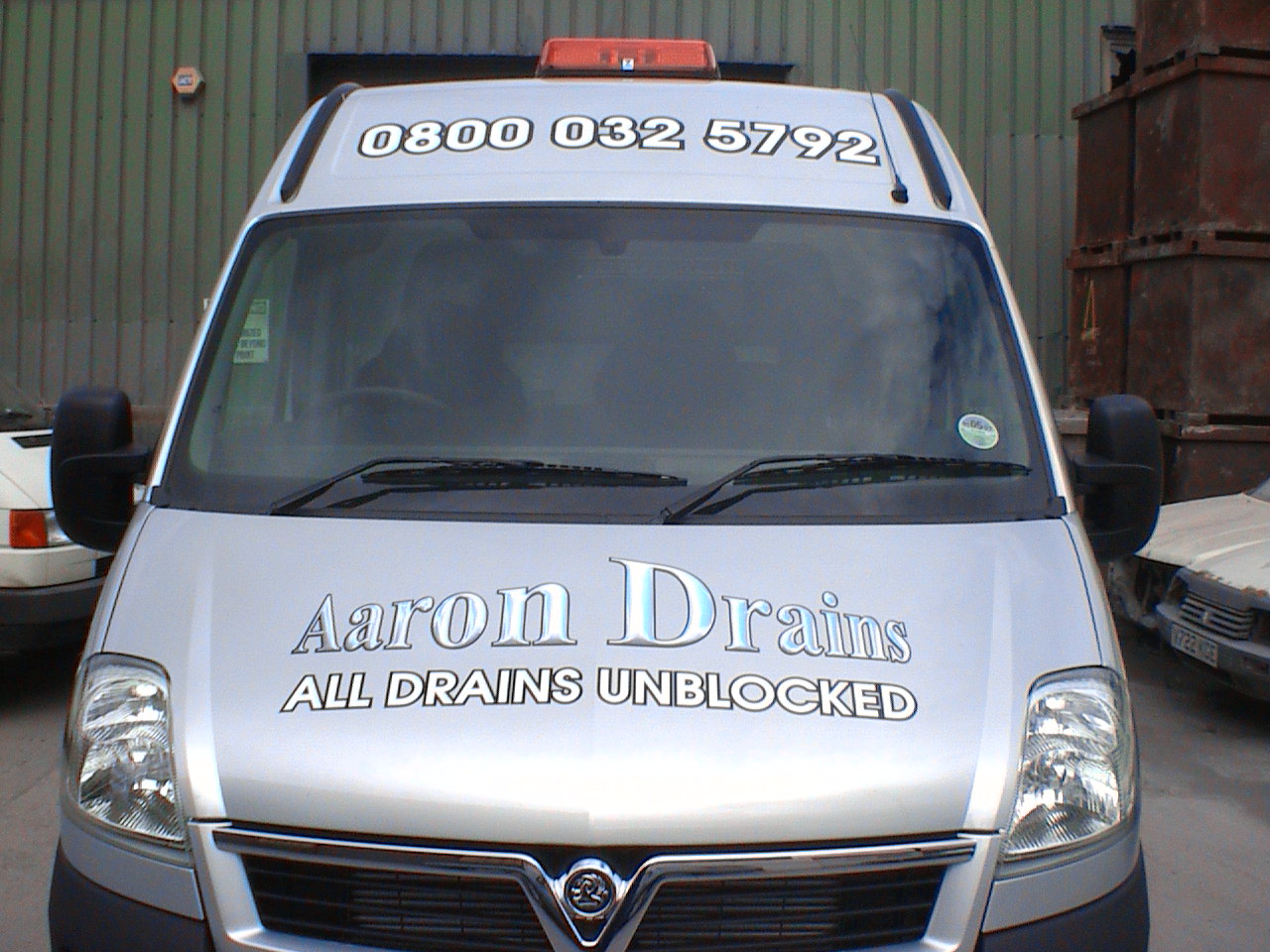

    eventually got the courage to offer part wrap as part of one of my designs, customer loved it gulp! so had to bite the bullet and give it a go..
    oracal command form and matching laminate.
    any price advice would be nice as i thought i was a bit cheap how long it took me?

    good job mate. The print is a bit ‘busy’ for my liking but if the customer is happy, that is all that maters
    How did you like the 3951?

    was impressed with 3951 have used both vws(kpmf) wrap media before, wasnt impressed with that stuff ones too thick to conform and the other has doesnt give you a chance to peel and replace, once its down you cant get it off without ripping. would love to try grafywrap but cant buy it in short runs you have to buy the roll…

    Looks good mate. Hows your laminator going?
    In was the pain in the butt bidding against you !!
    Bargain eh?
    How long did it take start to finish? Is the text printed too?

    the laminators going great, what a bargain laminated the 5 metre prints down the side brilliant..
    fitting took 14 hours on my tod, customer wouldn’t let me take anything off the vehicle so everything had to be stretched and cut round as good as poss. Also difficult to keep wrap straight on swage line of vehicle dont think ill offer band of wrap down side again..
    black and white text is cut vinyl Aaron drains is print and cut..
    i also thought text looked too busy.. first design lots more space left but customer insisted on more and bigger..
