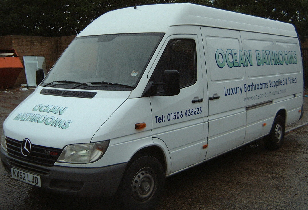

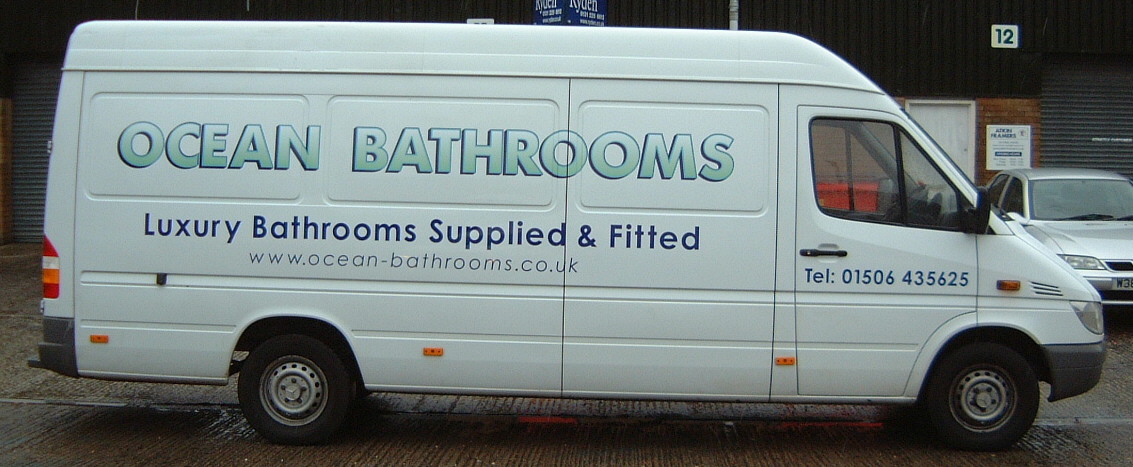

    Having recently bought a Cadet, this is one of my first print and cut attempts on a van using the new printer.
    The design was drawn up in Casmate Pro – then the main lettering was given a graduated fill using Corel Draw. The design was then printed – allowed to dry overnight, then laminated by hand with clear vinyl before contour cutting the lettering and applying as normal.
    I was well pleased with the result and the short time it took to fit this job. All in all a good learning exercise for me and the type of work I hope to do more often on vehicles.
