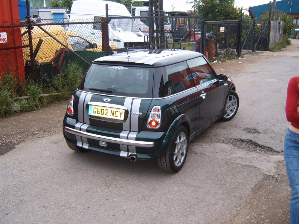

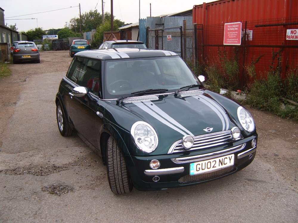

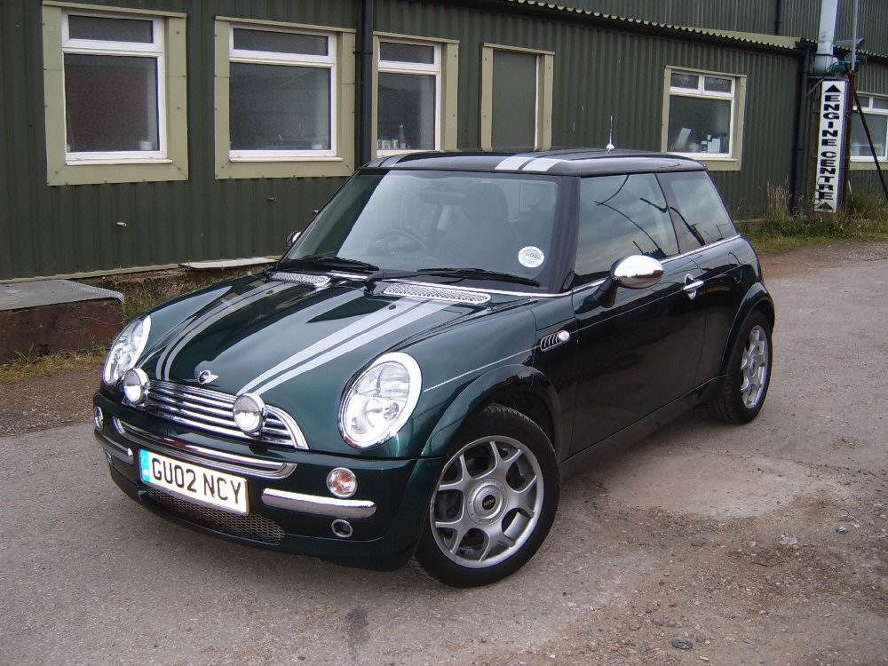

    nice work mate… not the normal i see running around.
    by the wya, do all your fitters wearing belly tops? 😛

    haha well spotted….u should have been looking at the stripe work though.
    actually she was the rather srummy customer.

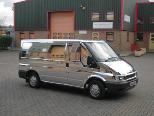

    and yeah i like to do things a little different.. remember this

    Really nice van, I’d love to do that to my mini :lol1:

    Hey Ian,
    Nice job on the Mini but my questions are about the Transit if that’s OK.
    Was that legally OK on the road or was that a promotion for Ford?
    What kind of Chrome vinyl did you use. I thought Chrome was not able to conform like that. It looks great.
    Mind you in Australia you’d blind everyone on the road. lol :lol1:

    I think it was done for a TV commercial from memory Simon. Was only on for a day or two I think. Could be wrong tho.

    the stripes are nicely done and the van is abolutly awesome, what vinyl did you use mate? the mirror we have doesn’t conform at all. would love to know how you did it.
  • ianahobbs
    7 April 2006 at 07:57
    vinyl was chrome from metamark but not just the polyester one it is the one with the polymeric backing.
    yes it was a temp job – 3 weeks in fact so pretty close on ya guess shane.

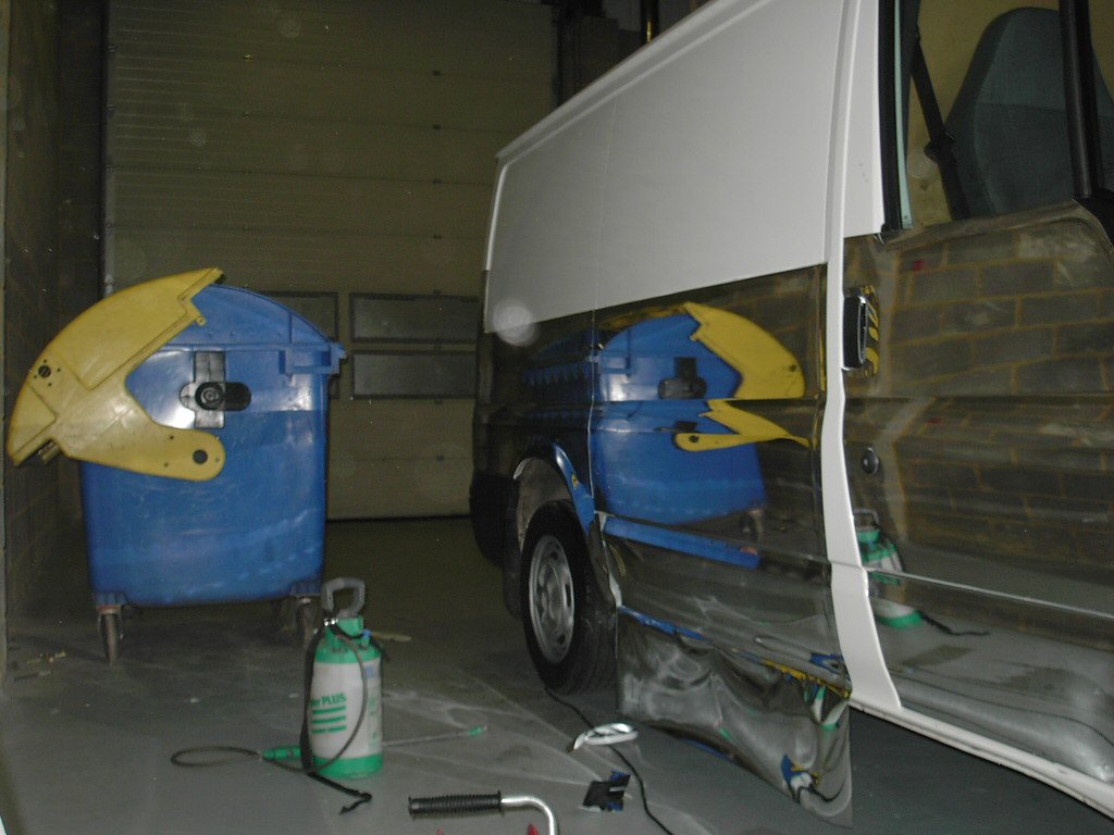

    if u look carefully at the sides showing the progress u will see i have started with the flat panels and only moulded overthe minimal creases, so basically i do it in sections with an overlap.. the bonnet looked kinda like fish scales as it was done in about 30 100mm sections overlapping away, not great up close but for the pictures needed it was fine..
    what u see is pretty much all we covered….only half the rear… half the roof and the complete passenger side was normal.
    i never did get a professional pic sent to me and im gutted the one i have of it is a bit blurred. but the relective / mirror van concept was used in bill board advertisements.
    yes it was a promo for ford and it was a thrifty hire van that had its
    decals removed by us 🙂
    just a fun job t be honest. hope i have answered all the questions..

    Hi Just seen the Chrome Tranny. Out of a matter of interest how much did you charge for doing the van and how long did it take you

    ok this was a rush job and i did price up…in case of problems.
    8hours = £2200.00+vat
    yes i know i should be wearing a mask, but hey no one else wanted to do it and if i was gonna take a risk it had to be worth it.
