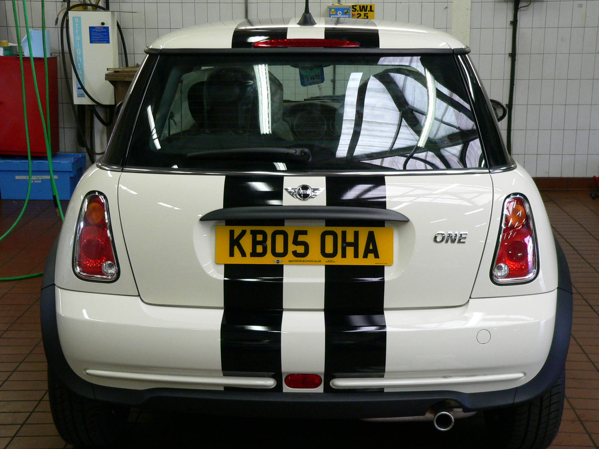

    Posted by Peter Normington on 9 June 2005 at 21:02
    whent to do a regular job yesterday, normally takes about 3 hours. so why did this take ten?
    The car is normally in a nice air conditioned or heated workshop.
    yesterday it was in the wash bay, workshop was full. No probs, under cover warm day…..,I failed to notice the roof, polycarb.
    set out the marks, started to lay the stripes on the roof. time is about high noon, black stripes get bliggin hot , job went twits up, had to go away make replacement stripes, for the ones supplied. go back and redo, me not happy.
    Lesson It can be to hot to apply Vinyl!

    21 July 2005 at 07:06
    dennis, it is not just a bulge, but a deep narrow reccess as well. The stripes (supplied by bmw) wil not conform enough to follow the contour.
    Earlier models did not have this shape.

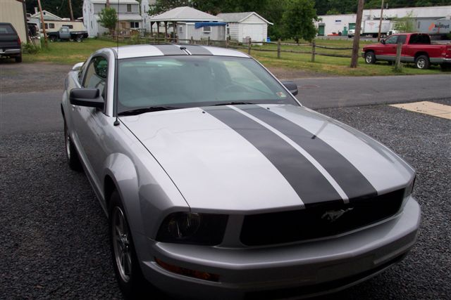

    6 September 2005 at 14:36
    I don’t know if this is the best way…. Peter seems pretty experienced with these, but iv’e done about 5 or 6
    I use Cast and apply wet with no tape. Spray it up on the table as i’m removing the liner, then apply with a felt. I’ll mark the car with pieces of masking tape before i wet it.
    Most times i’ll guess at the arc, and cut one from black calendered vinyl, lay it on and make adustments. Or lay a piece of paper on and draw the lines, then measure and guess. I don’t have a big scanner.
    You may get much better advice, but this has been working for me… so far.
    Last one i did only took about 2 hours start to finish, but there were no major obstacles..

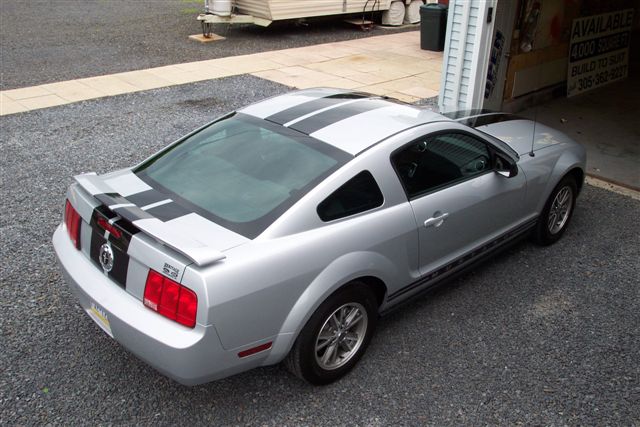

  • steve geary
    6 September 2005 at 18:06
    yes, that’s what i meant, but on the car i’ve shown, I only had to do that on the trunk lid. When I layed the vinyl over the edge it bent to the inside, because of the compound. So I cut one straight out of scraps, layed it on and measured on the car where it needed to be. Usually get it right the first or second time.
    The stripes on the hood and Roof are straight and went on quickly and easily.

  • steve geary
    6 September 2005 at 21:50
    quote Marcella:
    Is that the new Mustang Steve?
    Yes.. it’s an 05.

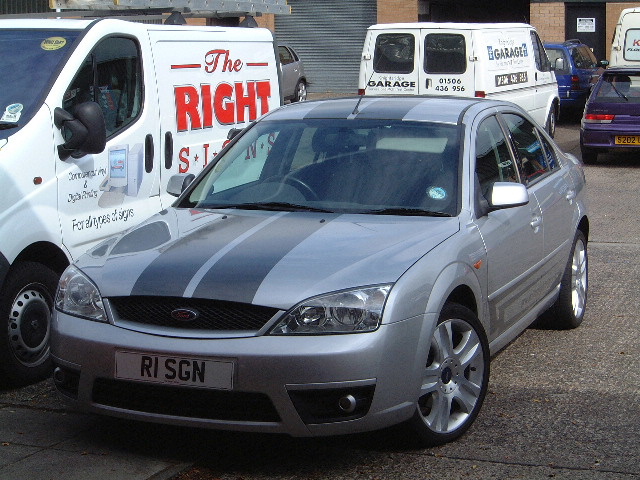

    7 September 2005 at 13:12
    After my disgraceful comments last night – and just to prove I am not “Anti Stripes” here is a picture of my beloved Mondeo (I really wish it was a Mustang – hence the Stripes).
    I also bet Andy some time ago that my car had stripes and said I would post a picture just to prove it

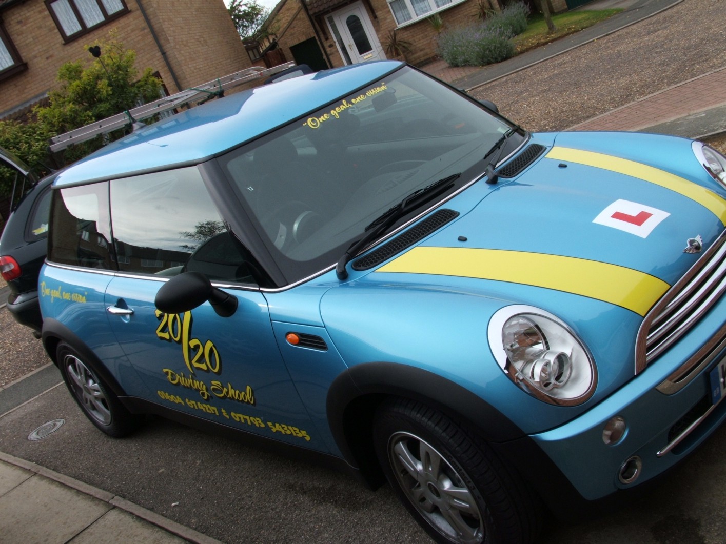

  • Andy Gorman
    7 September 2005 at 13:18
    That’s spooky. I was about to post a picture of a girly mini I did this morning. Wow Phill, I bet that goes really fast now. 😉
    Anyway, here it is, notice the lovely colour scheme (!)
