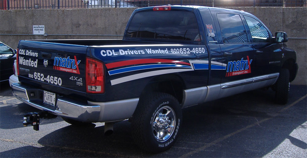

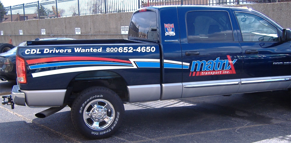

Posted by Misko on 4 April 2006 at 06:30Another job I just completed. All done with reflective vinyl except white outline around blue colour. The crest on the side was printed on reflective vinyl and laminated.
All I can say is that working with reflective material is a bitch.
This was my test for Nikkalite material, and it gets a no-go from me. turned out to be very brittle and falls appart easy.

Looks cool Misko, great job. Nice looking truck too.
Agree with you about Nikkalite, need to work in a warm shop as it is very brittle.
