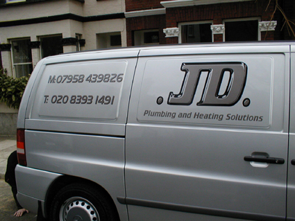

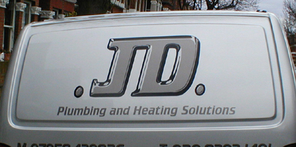

    Customer came to me with basic artwork (paid for artwork not from signmaker down the road! – different thread) scanned and converted to vector with encoragement from Stevos article.
    Numbers big on panel customer request not mine, otherwise i’m well pleased with result
    Photo could be better will try and find another

    3 shades of mettalic vinyl on black background, medium metallic for the main portion of lettrs and then lighter colour for highlights and darker for lowlights
    john
    paul no reg marks lined up by eye using clear tape (wet app sorry rob!) on bench then whole thing applied as one on site for speed
