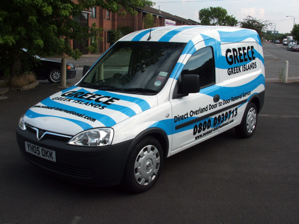

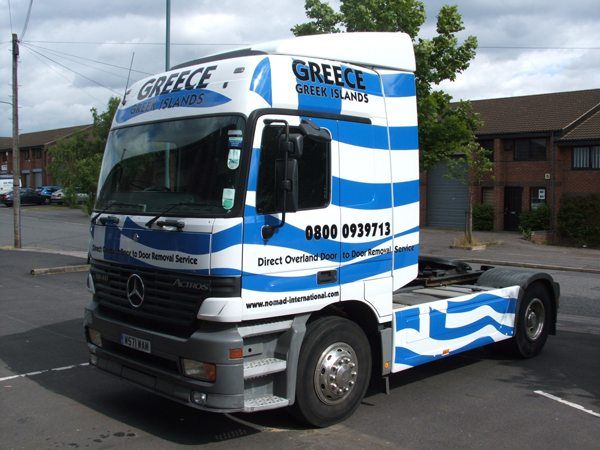

    Hi all
    This is what we did last week- we used more vinyl than expected!
    Darren

    11 July 2005 at 19:19
    Great job! You’ll never miss those on the road!

    11 July 2005 at 20:14
    Great Stuff, how much vinyl did they use??
    Simon
  • f1graphics
    11 July 2005 at 20:24
    They used
    100 metres of blue
    40 metres of black
    40 metres of silver
    Approx
    11 July 2005 at 20:27
    Dont tell me that was on one unit and a van! You must have done a few more!
  • Simon Clayton
    11 July 2005 at 20:31
    Now that’s alot…
    Simon
  • f1graphics
    11 July 2005 at 20:48
    Give or a take a few metres.
    It is very deceptive how much vinyl was used. The curved blue lines were not economical. We could only get one blue curve on a 610 width vinyl in most cases, so there was alot of wasted vinyl.
    I did estimate around 25% less vinyl
    11 July 2005 at 20:57
    really nice job done darren 😀
    you must be well pleased with the outcome 😛 on the matter of vinyl could you not have worked on a side at a time and butted the stripes in together to fit the 610 wide ? just a thought cause that’s a lot of vinyl used, but at the end of the day it’s all about learning thanks for posting 😀

    11 July 2005 at 21:01
    Good job!! They will certainly stand out. 😀

    11 July 2005 at 21:35
    Looks great Darren, you sure picked a tricky looking job for a first one 😉 The fitting looks top quality as well, so well done 😀

    11 July 2005 at 23:41
    And I thought my first car project was hard 😮
    Looking good and very well done!
    I really like the design with the real Greek blue.
    Good luck with your business and keep us posted.
    JJ

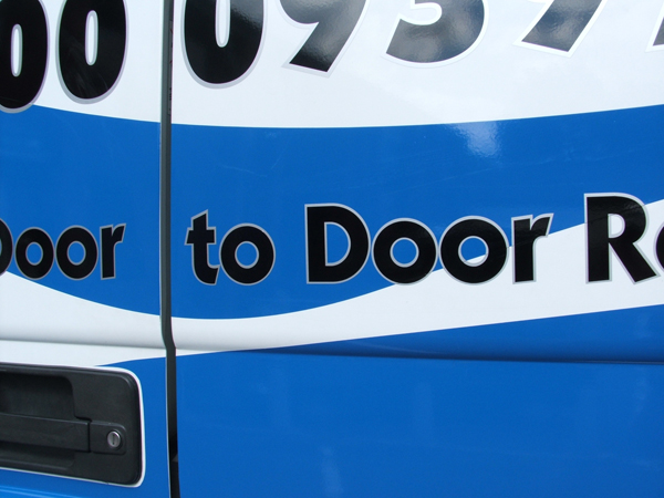

    11 July 2005 at 23:46
    A well fitted job. Well done. You’ve obviously taken great care trimming all the edges and tucking round the panels.
    I would like to see the cutting file for that, I’d like the challenge of doing it in less than 180 metres!

    12 July 2005 at 08:44
    As a matter of interest what would you have estimated the Vinyl usage would be if you was asked to price this job?
  • Andy Gorman
    12 July 2005 at 09:15
    I wouldn’t have estimated the vinyl usage. I would have nested the parts onto a page and got it accurate to within a millimetre. It may have taken me half an hour to do but it means that you never underestimate the amount (and cost!) of vinyl needed. Worth the extra effort when you are talking about such a lot of vinyl.
    You say you were 20 metres out? That’s £30 in vinyl using the cheapest stuff, plus application tape.
  • f1graphics
    12 July 2005 at 09:25
    In hindsight extra time spent estimating would have achieved the exact measurements.
    Unfortunatly sometimes its hard to allow yourself 30 mins on a estimate that may not come your way.
    I already have a list of things I’d do differently for the next lot. fortunatly for me the client loves the job and understands that I may need to charge that little bit extra next time.
    D
  • Andy Gorman
    12 July 2005 at 09:31
    Yes you’re right. You can’t always spend time on jobs you haven’t got yet. What with vinyl being relatively cheap these days, it’s probably easier to just allow plenty of spare.
    I’m stuck in the habit though, as I used to make graphic kits from vinyl that was about 87 squids a metre! You didn’t want to be a long way out with that!

    12 July 2005 at 21:10
    Know what you mean BG
    But a few weeks ago I had to buy some expensive stuff. and of course when you press the button to cut, the plotter gets its revenge 😀
    Back on topic. the Merc tractor unit and combi, I drew it this morning, and even being liberal with the vinyl, good only use 50 m for the lot max(blue)
    Sorry I didnt save the cut file. My gerber blew up and had other thing to sort. If I get a chance in the next few days will redo it.
