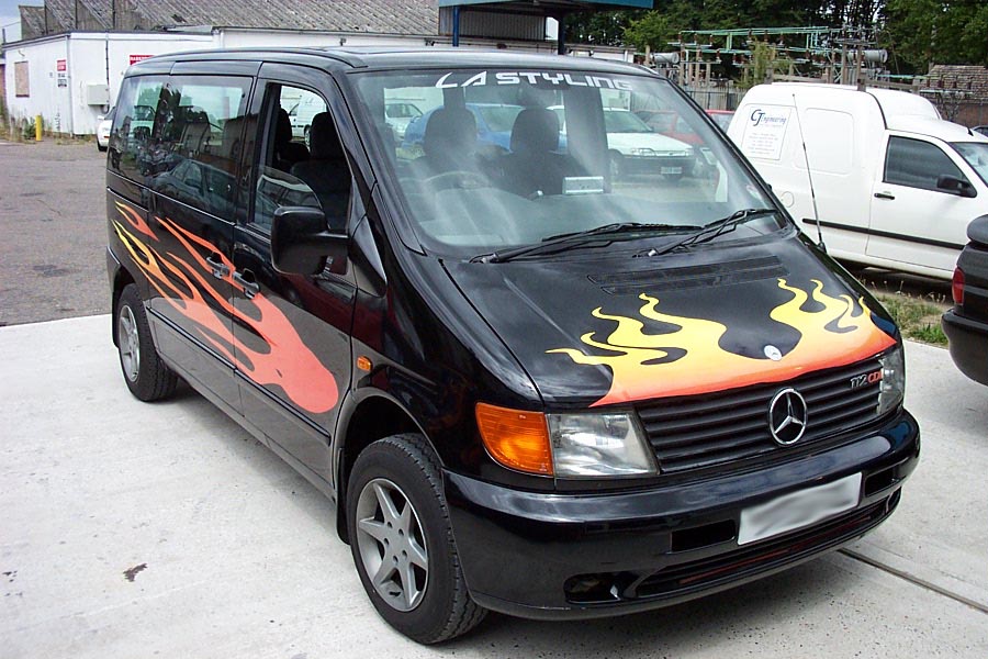

That looks cool
Did you do the printing as well or did you outsource it
Nicely done though
paul r

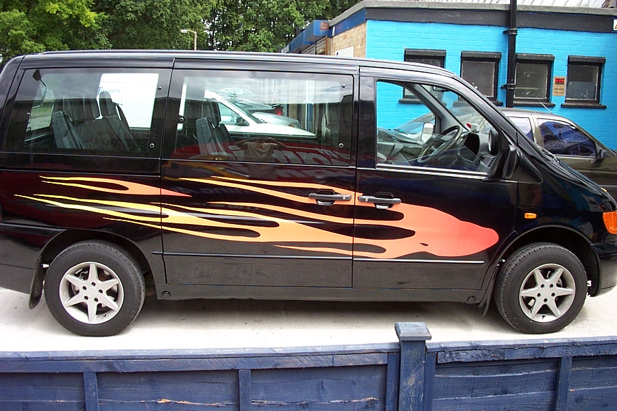

Yeah it was printed here on our Cadet. We had a bit of a nightmare with the cutting, it kept cutting the outline and leaving white vinyl showing through. I ended up having to draw round the entire lot leaving 2-3 mm of colour outside the cutline. Oh well at least its out of the way and a few lessons have been learnt.
