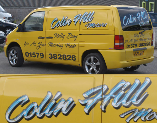

that looks great, love the name/ print
how did you do that effect?

Great work Chris. I really like that. 😀
I too wonder why we don’t see more print and cut examples like this out and about. Many signshops have been using print and cut machines for years now, and yet still print and cut examples like this seem to be few and far between.
hi chris, i really like that effect you have, nice shiney chrome. works a treat… what package did you use to create and was it combined with a plugin like alien skin or eyecandy?
constructive crit:
over all the design is very eye catching but i feel the continuation of the script etc sorta leaves the design needing tied together in some way?thanks for taking the time to post your work mate, great stuff 😀
Love it Chris, can not believe how effective it looks.
Well done

thanks guys 😀 your comment noted rob i will pay more attention next time.
its all a mix of co rel & photo shop with some plugins and comes back in to corel as a transparent tiff where the orig anal text can be used to create the cut path which is laid over the image and sent to the rip at half or third size then scaled up

good work Chris, looks great.
Theres some great work coming out of the devon / cornwall area these days and I’m sure that counts as one of them.
keep up the good work mate

I missed this one
Great work Chris that looks fantastic

I missed this one first time round as well!
Looks good though, I like the chrome but a bit too much script overall I think.
What did you charge for this one….290-350ish?
