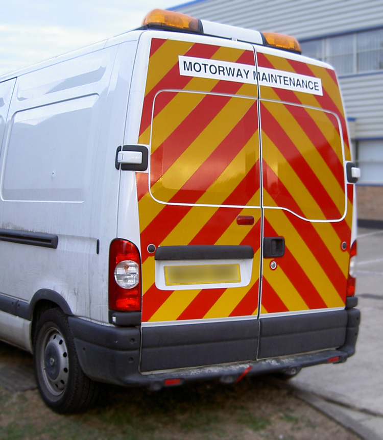

    Well not very exciting but this was a job that I grew a few grey hairs over…
    I was let down by a supplier, who was going to produce kits for me to fit, but
    they then decided that they were too busy to supply me within a fortnight, so
    with alot of scalp scratching I decided to go with LG class 1 microlens as to the customers spec,
    cut it ito 6" strips and fitted direct to the vehicle and trimmed.
    MB

    mark, that would have been a hard job 😮 . you have done well.
    chevrons are not the easiest thing to do at the best of times, but over this area and size, a good pat on the back is in order mate….. 😛
    19 September 2006 at 10:37
    Nice neat work mark! well done! 😀

    I know how difficult this can be to do. Looks a top quality job matey. Well done. Are the stripes butted or did you flood with red first?

    Thanks for the comments,
    As this is my first one, I was worried that I had made a hash of it.
    I bought in the LG material at 1500mm wide and then cut it into 6" strips,
    I then butted them up on the back of the van and trimmed,

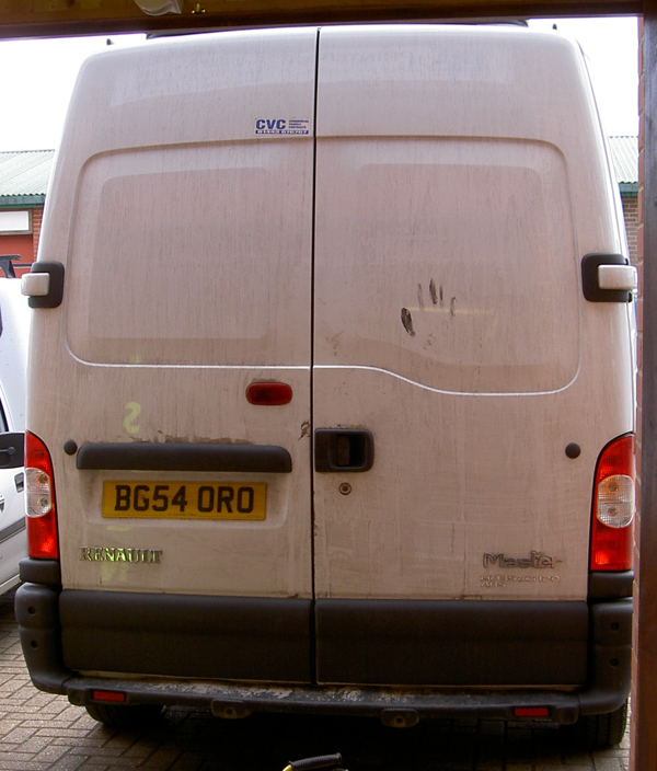

    This is how the fella came into me..
    Some customers……….

    Nice Job! I just did the back of a Peugeot van but only lower half of each door. I used the LG and found it great to work with. I actually overlapped the strips as Iwas worried about shrinkage. Will posta piclater for you.
