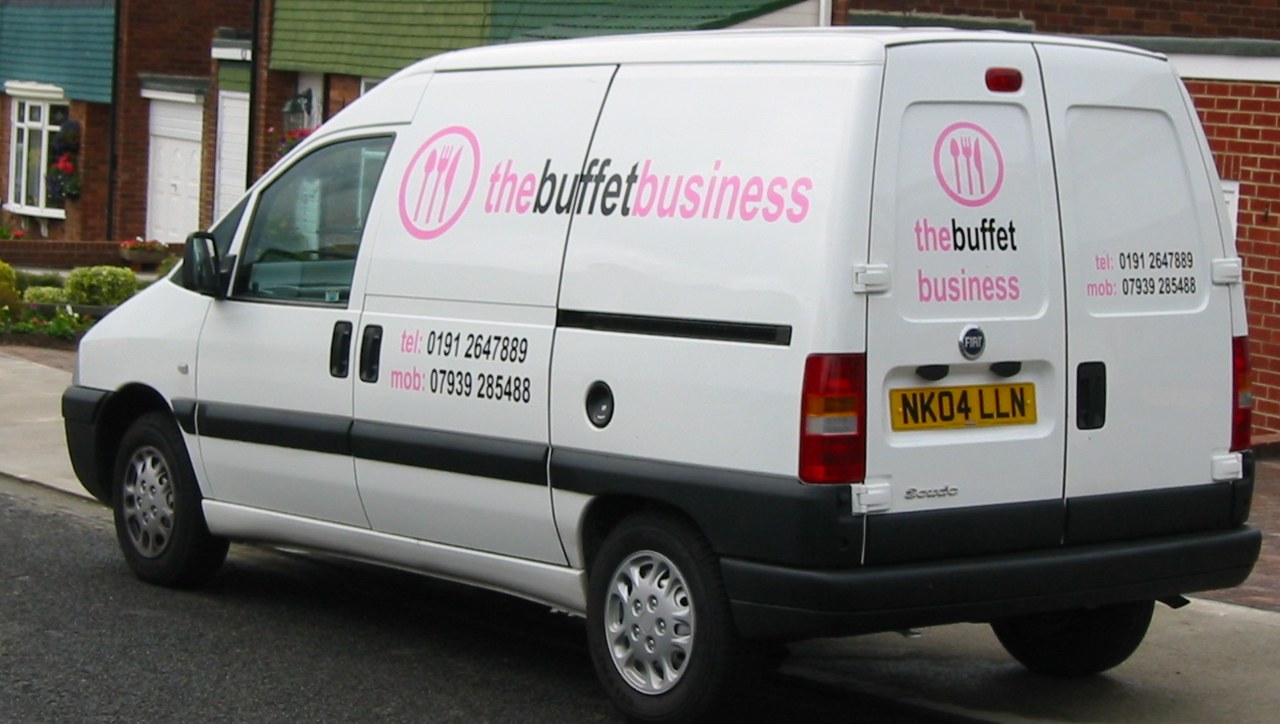

    hi everybody here is a fiat van i have just done any suggestions
    i was told where to put phone numbers
    and the colours were specified
    this is second van i have done it was applied dry in between rain showers
    as i have no garage
    the problems i had were lots of bubbles in black text some in the pink but not too bad the vinyl i am using is mactac 9800 pro both black and pink
    application tape is perfectear 50 the van was cleaned and i wipe down with isopropanol alcohol
    my first van a merc sprinter was exactly the same most of the vinyl went on no problem but the black bubbled up i saw the van yesterday and the black had no bubbles in it how can i speed this up as it does not look too good when it is just finished i have seen various application fluids would any of these help
    or is it just me is the black thinner than the colours thanks
    cheers dex

    Hi
    Nice looking van. Clean, simple and to the point.
    Regards
    Lee

    13 July 2004 at 16:11
    Looks good.
    If you are having bubble trouble; what squeegee are you using? The reason I ask is that I have found myself using a felt squeegee too often and they don’t put vinyl down as good as a plastic one. Even with application fluid you need to get some decent pressure on to get it all out.
    I have found that the Mactac vinyls do tighten a little after a few days which improves the appearance of any small bubbles. Some colours do appear a little softer than others, you just get used to it when you become familiar with a vinyl range and make allowances for it.
    Is any of this helping? I’m rambling on a bit. Anyway, I like the van. Very tidy.
    13 July 2004 at 19:45
    nice one dex!!
    your layout is very good, especially on the back doors, i have seen a few vans around, that are really awfull, the lettering is squint, the person that tried to apply did not know how to do it!! 🙄 🙄
    anyway well done!! 😛 😛 bubbles are a nightmare, but as it’s only your second van, practice makes perfect!! you’ll get there!! 😀 😀 😀
    Nik

    hi thanks for the comments i used a felt squeegee
    i shall invest in another sort to try where is the best place to get a selection i tried with the layout not to get too fancy (less is more ithink they say)
    how much would you charge for this job
    its now 5 to seven i am off to a track day first time back on a bike proper for over two years
    then three nightshifts so i will get back to the boards later cheers again
    dex

    14 July 2004 at 07:38
    Nice looking job Dex and don’t worry about the bubble you’ll get it with time, there is a book available called “Vinyl graphics how to” by Larry Mitchell, its a yank publication but you can get it from AS Handovers 020 7272 9624 its about £15, btw if you ever get as far as Cadwell doing track days gis a shout and I’ll stand you a cuppa its only down the road.

    14 July 2004 at 22:35
    Nice job Dex :2thumbs:

    15 July 2004 at 15:27
    cheers i have just ordered the book £10 plus postage
    stil looking for decent squeeges supplier
