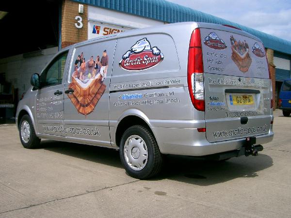

    We had done several normal prints but the following picture is the first van we used our versacamm for. We laminated them before loading them back in the versacamm so it could decal cut them. The spa is done in 2 panels with the join being on the first part of recess (parallel to the floor), so it is not obvious. The vinyl used was Spandex polymeric Image Perfect for the print on the sides and Spandex one way vision film for the rear window. This was also printed on the versacamm, but not laminated, so we will see how long it stays looking good! The rest is Gunmetal text with a white reflective outline.

    I think you must of spent too much time at the computer yesterday Robert. The answer to both your questions is in the paragraph before the photo. 😕
