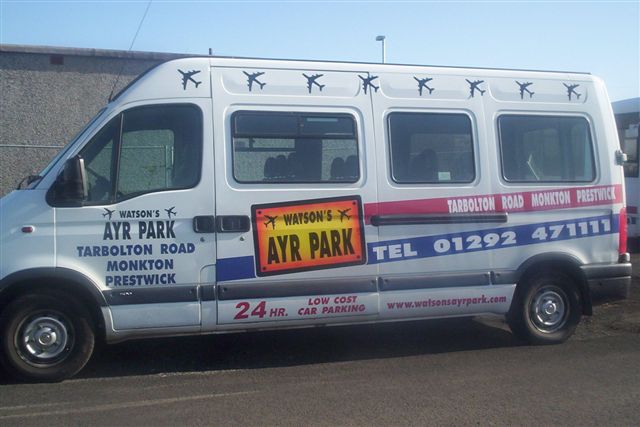

    hi john
    thanks for taking the time to post your work mate…
    what sort of vinyl do you use mate. thats the second post ive seen tonight from you with digital prints?
    do you print your own stuff or sub it in?
    if do yourself, what type printerare you using? sorry for all the questions, just plain nosey mate 😀 :lol1: tell me to bogg off if you want 😉

    I’m nosey too-prints look good on both jobs John, and I also woud like to know what printer you are using (i’m in the market for one myself)

    Hullo guys, i mostly use oracal and mactac vinyls, 3-5 yr, sometimes cast if i think i need it, latest postings, arran vehicle had orajet vinyl for print, and orical 651 on text. the watsons ayr park vehicle was done with mactac 3-5 yr, just to let you know the logo was, sray painted with orange, then applied with vinyl, other digiview vehicle was orac 651 and mactac imajin digi vinyl, i have a roland resolve 54 inch print and cut, which uses uniform activsol solvent inks, only had it from last october, it is not as fast, as new models like the cadet or versacamm, does the job for me, at the moment, i still think they are a long way away from complete prints, that wont come off or fade, was amazed how different prices for work. in scotland and england, can differ, some guys are falling in to money, some others are just plodding on!, moved into vinyl 10 years ago, but still have hand painted customers, from 20 yrs ago, will post more as we go along, thanks for interest, JOHN JBS 😀 😛
