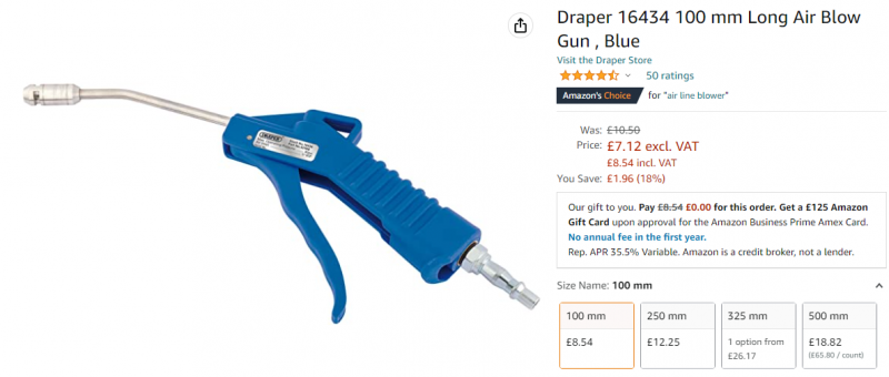

    Other than normal cleaning a useful tool is an airline gun, or just use the air hose, both from a standard compressor. an airline gun is great for blowing out the crap from within areas that you cant remove. it also helps if you are trying to dry off a vehicle when washed because you blow out the water that would otherwise run out down your dry bumper or the like.

    not that i have a compressor but the air gun is a great idea. i never would have thought of that. 👍
