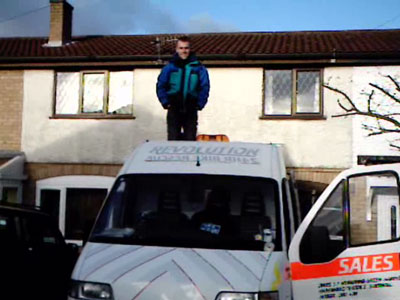

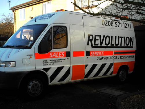

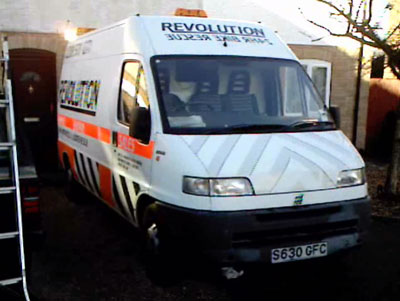

    wee! Just finished a van for a friend of mine. I don’t do many signs as Im tending to focus on t’s alot more. But he asked me to do it so I said yes.
    Whoops.
    It took AGES!!! I know we f*cked about alot and went to the pub which meant slow morning starts (ok it was afternoon starts) but it still took us about 18 hours to do it. Crazy.
    Dunno if the styling is to most peoples taste, but it was intended to stand out, the zebra stripes on the side are actually reflective, cool! Reflective black, looks smart at night.

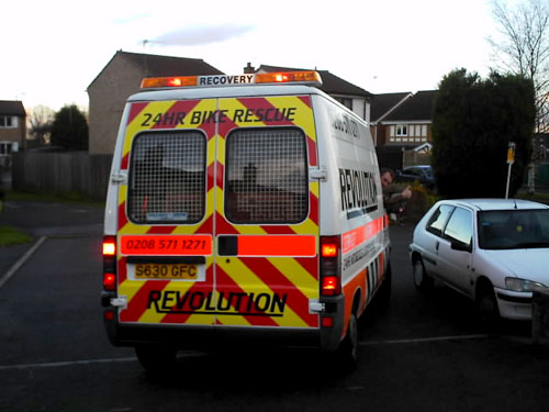

    Don’t even start me on the chevrons, never again. Well not how I did them anyway, first the yellow ones, then I put the red on. Is there a better way?
    And all cut on my trusty antique Graphtec FC2100-50.

    more!

    It looks like a blooming good job from where I’m sat mate 😀
  • Clive Martinez
    17 December 2004 at 17:17
    If your t shirts are as good as the van… you have a winning formula….
    nice job
    17 December 2004 at 17:21
    nice one that will certainly stand out , was it your idea to use mostly reflectve ? we use quite a bit of reflective but haven’t used black yet
    Good job
    17 December 2004 at 18:26
    Nice job, everything people need to know is there and it will get noticed, especially this time of the year when it gets dark earlier with all that reflective on it. I have to agree as well, black does look good at night. Chevrons, I’m glad you asked because I would like to know as well, I mark a line at the angle where the first stripe is to go and just work my way from that alternating colours, I’m sure there must be an easier way. Robert will probably tell us how we should be doing it.
    One question, is that ordinary orange vinyl or is it floreusent?

    Reflective black shows up orange at night doesn’t it? Only used it once many moons ago.
    When it comes to pulling the stuff off, make sure your busy that week. It will take you more than a few beers to get thru it 😕
    Excellent job mate.

    Just noticed on the back of the van its says:
    24hour Bike Rescue
    If you’ve got to wait that blinkin’ long you might as well walk home

    For a one off, constructing the chevrons using stripes on the van is probably the easiest way. If you ever get an order for more than one of the same vehicle a good and quicker way is to make a template of the rear and use this as a jig to pre cut all the pieces in advance.
    Shane, all the black reflective I’ve used reflects white, which means you have to be careful where you put it on a vehicle.
