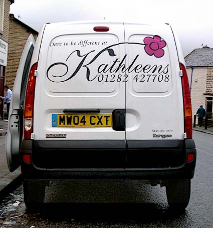

Posted by magpie on 17 December 2004 at 09:39My first van, constructive crit welcome.
These pics don’t show the sliding door side which really determined how far
I went with the sides as there are so many recesses to take into account. Belive me on my first van I wanted to avoid them like the plague.
Vinyl Oracle751, time to setup, cut, weed, wash/prep and apply vinyl approx 7 hours 😳 .
Go on tell me it shouldn’t have taken more than two 🙁PS Big shout to Brian Hayes for the outline, order is on its way. Thanks.

Hi there mate,
well what can i say, great looking design, nice and clean, modern, looks great! you should be proud of yourself 🙂
Well your production and labour times will reduce with time as there are always little knacks you pick up on the way to take onto your next vehicle, working with shaped panels and larger graphics are different to a flat sign panel. I think my first van probably took us that long to do to be honest, you’ll find in time you could shave that time in half. 🙂 .
Take care
Stephen & Carrie
Mate, I would not have thought that 7 hours to do everything was not too shabby. :thumbup2: You will get quicker of course, speed comes with confidence.
Don’t skimp in the cleaning process though, because any corners cut there will surely bite your later.
Well done.
Shane
Nice mate, why no phone number on the side?? it all looks ok apart from the rear door, not liking the logo going into the gutters I know you have to do it in the middle but it looks as though you’ve cut it too big.
Also the phone number I’d have done pink too. -
I like it.
It’s simple and not all cluttered up.
And pink is my favorite color.
Constructive critz would be as Steve said,
maybe have made the back a bit smaller,
I don’t mind the black phone # tho.
And why is the logo on the side twice?
I think I’d have just put the flower
with the # underneath it.
And what does Kathleen do that’s so different? 😳
Flowers? Apparel? Stripping?
Inquiring minds want to know.
I do like it….just busting yer chops.
Love….Jill -
Thanks for the vote of confidence guys. I must admit I was a little suprised when
they said the tel. no. was just to go on the back, perhaps I should have urged
to go for the sides too. Also now Steve mentions it, I should have gone smaller
on the back doors and I like the idea of the tel. no. in pink. I’ll have a play around
on screen for curiositys sake.Carrie/Stephen I’m glad you said it looks clean and modern as thats the look they
were after.Shane I hope I have done a good enough job on the cleaning, I gave it a good wash
(washing up liquid, as I assume there are no silicates in that) and rinse. Then to
remove anything else which might remain I gave it a going over with U-POL(?)
panel wipe (which I thought was very reasonably price, compared to what you pay
for some consumables).Also I have the chance of someone elses van off the back of this. Although I’ve no little
contact stickers of my own yet – must get that sorted!Cheers, Pete

Top job mate! Really really good! 😀
How did you find it? What I mean is, did you find it easier than you expected or harder? Nowt wrong with 7 hours mate, if thats your first, 7 hours is bloody good going, especially considering the design. As C&S have said, very clean and professional looking, you’ve done a great job.
As far as putting your own stickers on, whizz me across your design, shop email and I’ll chuck them through the PC60 if you like. Quick and easy for you, gives you some more time to get the next van 😀
As has been said though, you build in confidence with each van until eventually you work out your own system for applying it rapido. If you take the care and attention you’ve just done with that van on every van, but manage to speed up your app time, you’ll have more van work than you could shake a shakey thing at 😀
Cheers, Dewi

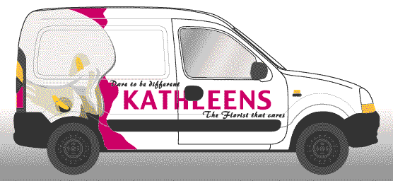

Finally here’s another layout for the same van, but as a half(?) wrap.
Cheers, Pete
Hi Pete
Nice first van :2thumbs: 7 hours isnt shabby as already said
