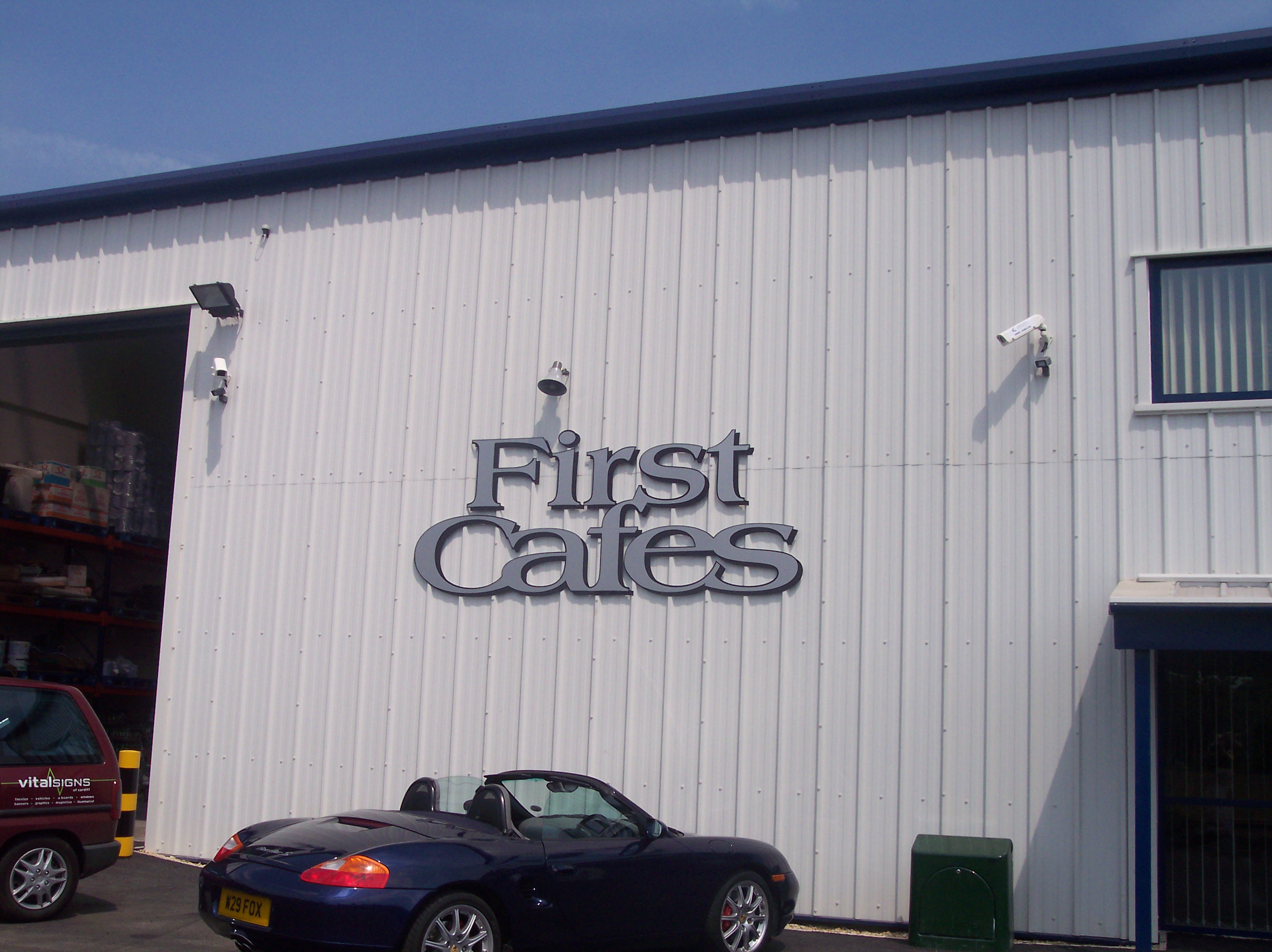

    I really like ‘First Cafes’, but personally the Madge Simpson hairdo is my favourite :lol1:

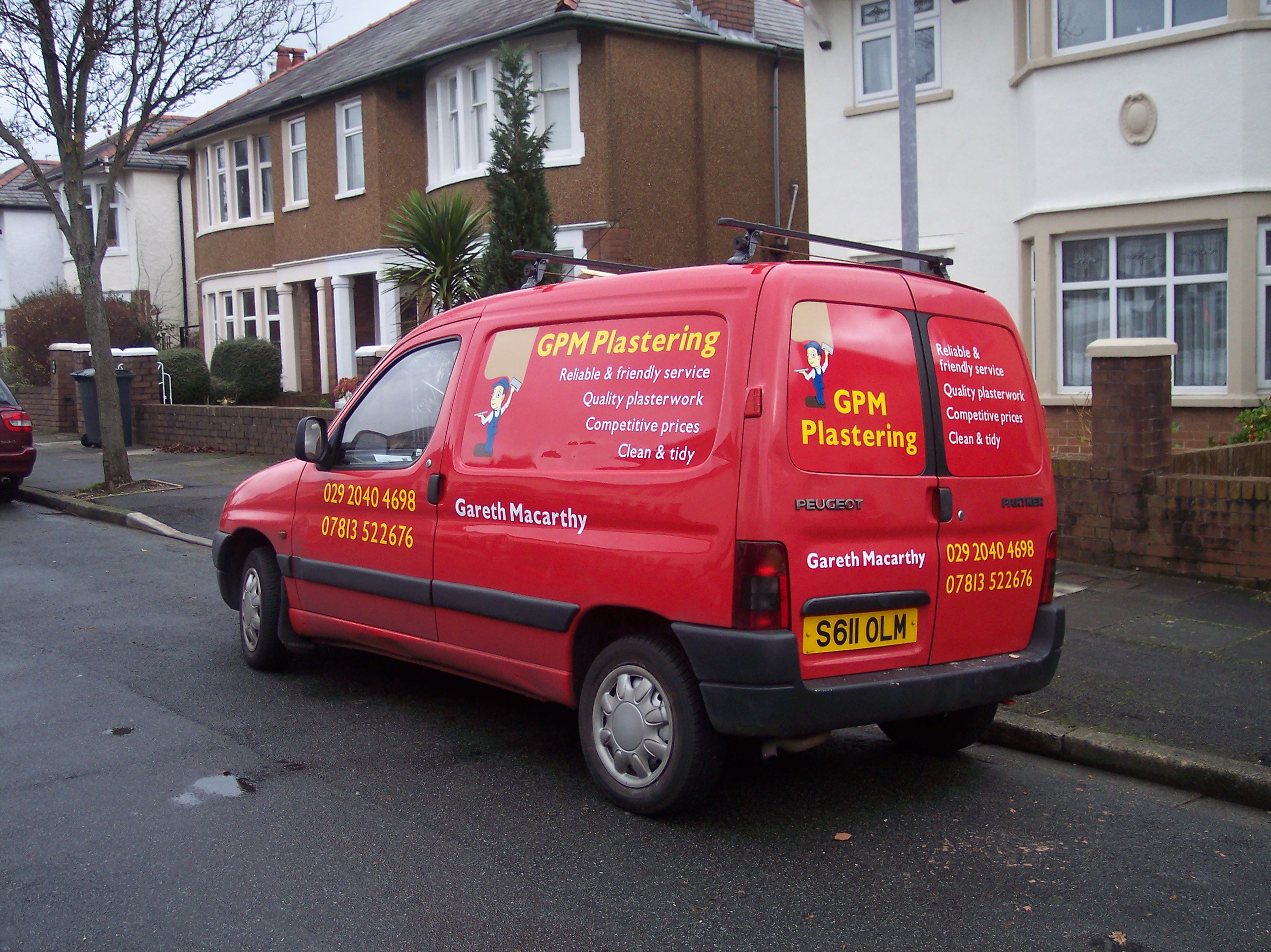

    i too love the First Cafes sign it just looks right

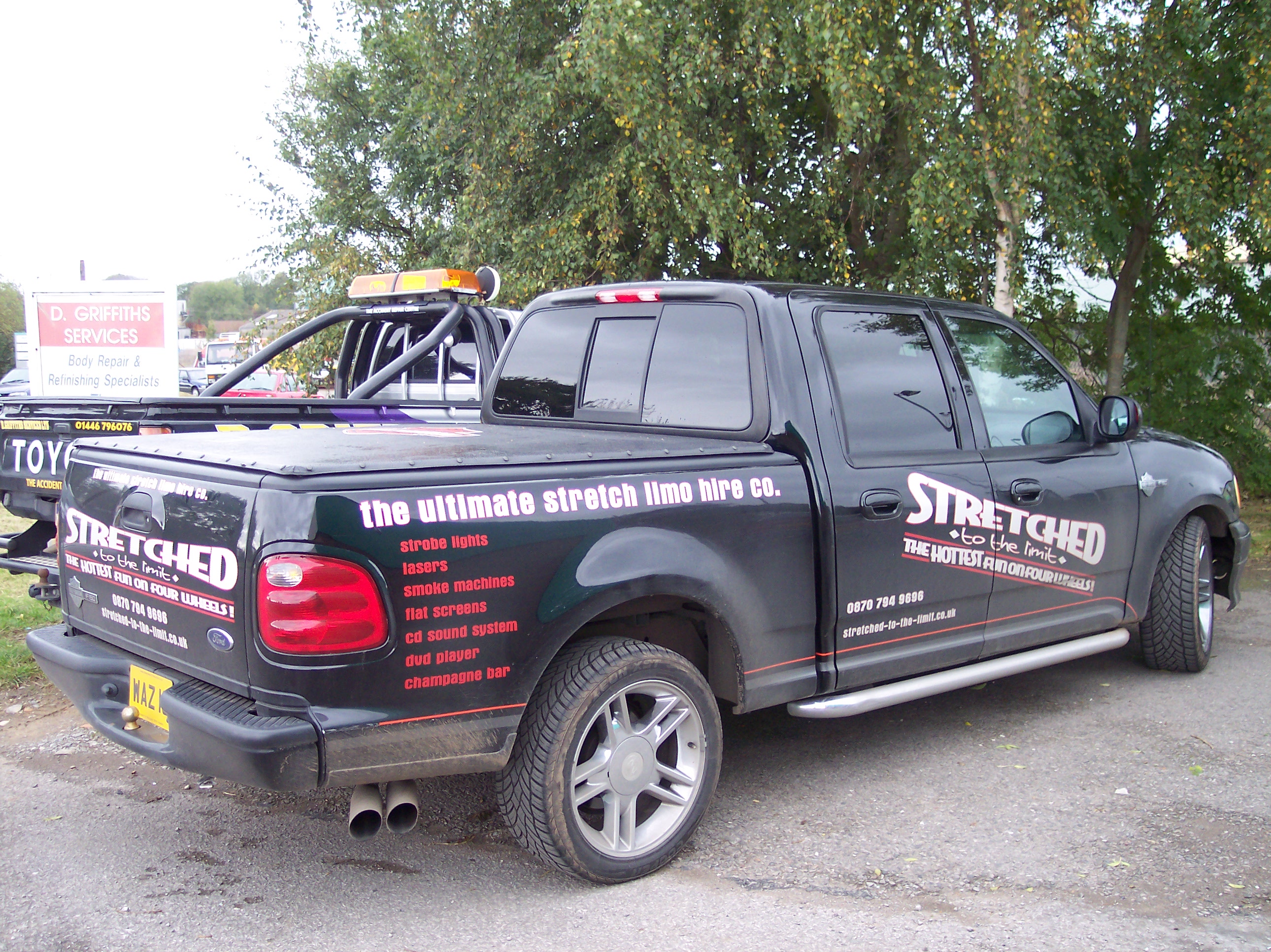

    i also like the look of the ford pick up
    not so sure on the plastering van but just because i dont like clip art
    great work

    on the "stretch" you said holographic vinyl which is it, must be pic but don’t see holographic how has it lasted thanks for showing I also like the first cafe, did you make the words as well ?

    Lynn, the holographic vinyl was only guaranteed for 6 months but the customer really wanted it. It hasn’t lasted too well which is why you couldn’t see the effect. The photo was taken about two years after fitting. The chap who had this done has since sold on the business – see Ben’s limo wrap recently for the new owner’s take on vehicle signage (a cut above methinks)
    I copped out of making the letters for First Cafes, got Westward Plastics of Bristol to router them out of black alipanel in kit form and then I riveted them to the cladding and stuck on silver Oracal 651 over the top to create the shadow/outline and to cover the rivets.
