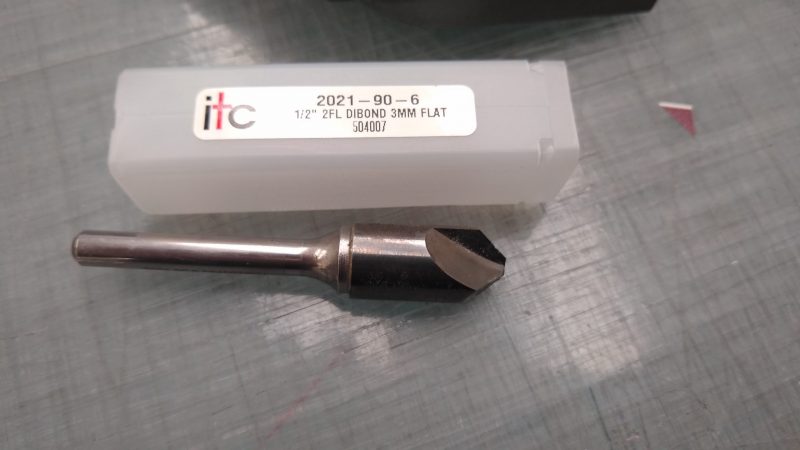

    I wouldn’t be to concerned about its power for all your doing with it. A 1200w should rip through dibond no problems. The bit we use came from ITC, it’s a 6mm shank so would fit your collet. If your router has an edge guide you’ll find this extremely useful for keeping it running straight at a set distance from the edge.
