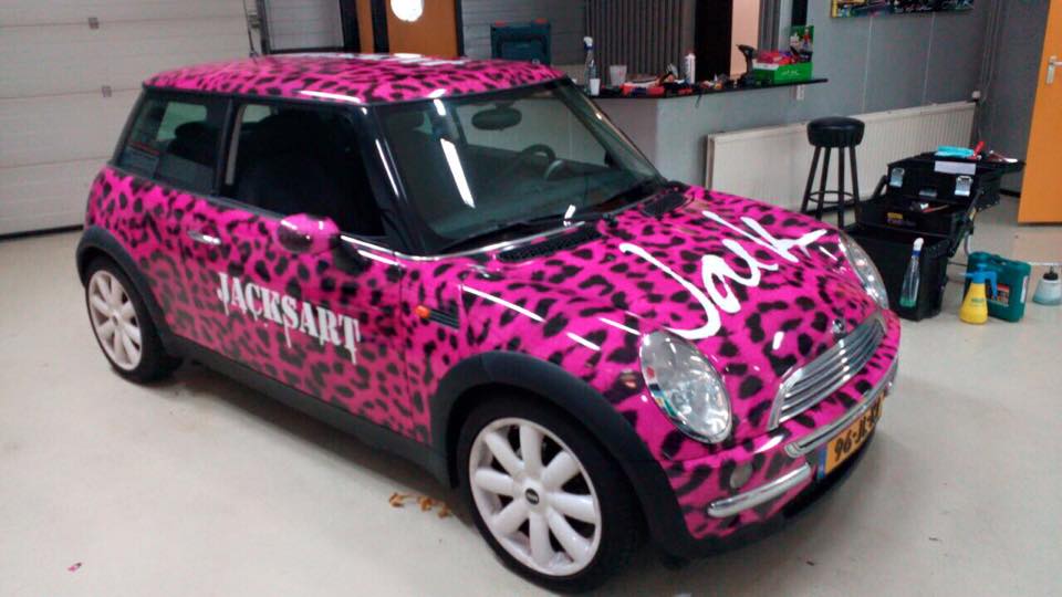

I print allot of "vehicle graphics" that are either un-laminated or laminated.
We have not had a single problem with them since having our lightbar installed.However. you will see from the original post i made, this was installed on an OLD Grenadier / Roland Soljet printer which is about 11 years old now i think. So I do not print wraps using this machine because it is just too slow. We opt to run wraps on out HP Latex 360 machines. So I have no real world testing to go by, hence why i have not reported my finds.
However, I did do a series of tests on the inks on the UKSG Wrap Training vehicle on a series of very demanding panels. the prints worked perfectly fine. also, if you take the prints and pull the vinyl you will see the prints do stretch. however, as i said, as i haven’t been able to test these on a live job over a significant time. I cannot give an accurate report when it comes to over stretched wraps into recesses.What I will say is, i have heard of companies already running lots of wraps via their lightbar. i don’t know them personally
but this is a picture of one of many they have done.The following Mini was done by CL Signs in Holland
So in a nutshell, done tons of vehicle graphics laminated and un-laminated. no problems at all over a period of a year or so. vehicle wraps, i have not done anything long term or large enough that i would term as a wrap. once i do i will post it here.
