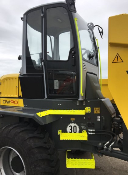

    we have done the steps and rails before Chris, I am "guessing here" but i think Peter will be talking about the face lip of each step. the attached picture is kinda what they are trying to replicate on new machines that don’t have this type of marking. though the ones we have done have had much more coverage on much bigger machines.

    Thanks for all the replies, Robert is correct it would only be the face edges of the steps and handles etc. The client has tried removing and painting also powder coating and they are fading after a couple of months so we are trialing the cheaper and hopefully longer lasting vinyl route.
