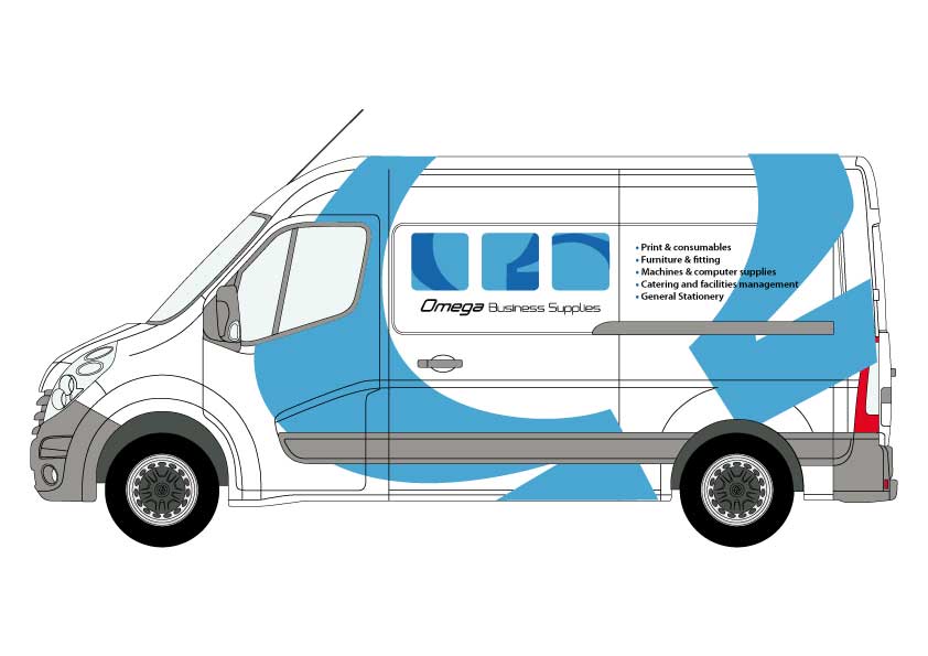

    I’m currently debating how is best to install the oversized logo on the sides of this van, my first real
    I am using Oracal 751 Cast vinyl, 1230mm, and will have to tile the logo into about 3 pieces, this is my first tiled job, and my first real job where I am going to have use my newly found wrapping skills.
    Should I still apply application tape to the logo, or just use magnets to get it in place then apply from their but by bit?
    I am planning on using a 15mm overlap for the tiles.
    Any advice welcome.

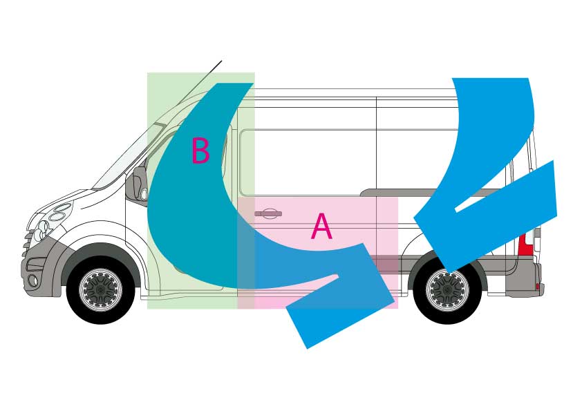

    Might be 2 metres wide overall David but you have 2 distinctive halves which could be cut separately & lined up on the van very quickly before you started to apply.
    23 August 2012 at 14:45
    Just trying to get my head around it?
    Tile it something like below, so the join falls where the passenger door is?

    Can should be with me this week, and I’ve got all the vinyl cut ready.
    My plan is to apply the logo to the high points of the van, around the panels, then work from the centre to the panel outwards leaving about 100mm to stretch into the recess.
    I assume best applying to the flat area’s with the app tape still in place, then removing prior to working into recesses.

    Raising a previous post, I as have had the vehicle all day, and after numerous attempts to get the F*ing logo on the van, We’ve managed 1/3 of the logo on one side.
    Customer isn’t happy, and I am even more Pee’d off.
    We’re struggling to around the door handles. We’ve tried applying as if it were a wrap, applying to the highest part first (the rub stip) and then work our way out, leaving 50mm off the paintwork between the door panel and the rub strip to work in.
    We’re using 751 which can be pulled off and repositioned but it’s certainly no wrap film.
    someone please help!
