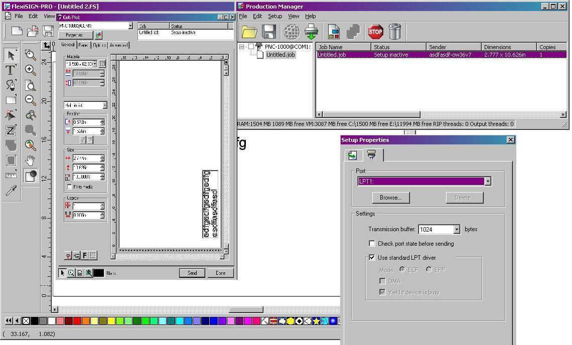

    Is there anyone who might be able to let me know if i’ve got the setting right? I seem to be able to get the pen to jerk on file input but no further.
    Any help would be appreciated!!
    Thanx and have a good day!!!
    rick

    make sure the cutter is set for MODE 2 which is HPGL
    Mode1 is rolands proprietary language.
    with the cutter set for MODE 2, any hpgl driver should work.
    also, you need to go serial.
    Unless you set your parralel port to SPP instead of EPP or ECP in the computers BIOS, it wont work parralel.
    Pentiums and up have high speed parralel ports and the pnc 1000 cant accept data at those speeds.
  • Rick Wiggins
    24 August 2010 at 23:52
    Frank,
    Thanks very much for the reply…..
    I do have set at MODE 2 on the plotter….
    And I do have it set to parrallel….
    I do not understand the SPP, EPP or ECP
    Attached are some of the settings to show you what i have…
    on Flexisign…..
    the OS is XP and its an older computer for the XP to run fine
    rick
    thanx again!!!! :lol1:
  • Frank Droog
    25 August 2010 at 13:20
    it will probably work immediatly if you have a serial cable.
    If you have anything better that a 33 megaherz 486 computer, you will probably need to change the parralel port mode in your computers BIOS.
    When you first start the computer, you should see something like PRESS DELETE or PRESS ESCAPE to enter BIOS.
    Once in, you should see a setup menu.
    You should see a menu item about peripherals
    You should find somthing about LPT and COMM ports.
    You will see that you can switch the LPT from SPP/ECP/EPP mode.
    SPP is what you want and stands for Standard Parralel port.
    The other 2 are high speed ports.
    If you find it and change it, you need to SAVE and EXIT.
    If you bought the cutter brand new 10+ years ago, you should still have the serial cable it came with.

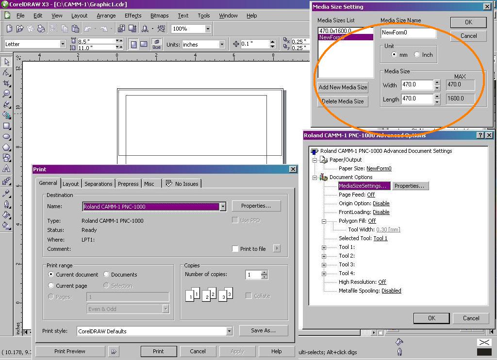

  • Rick Wiggins
    26 August 2010 at 15:48
    Frank…..
    thanks for the info….. WOW…..
    Actually…. i’m continuely working with the thing and have got the pc-1000 to print (i just have a pen in it now) and it’s off COREL 3x using a parallel.
    I still need to get the ‘media size’ figured out and all but i do get a printout.
    Do you have a working pc-1000? and if so what software did u run it on?
