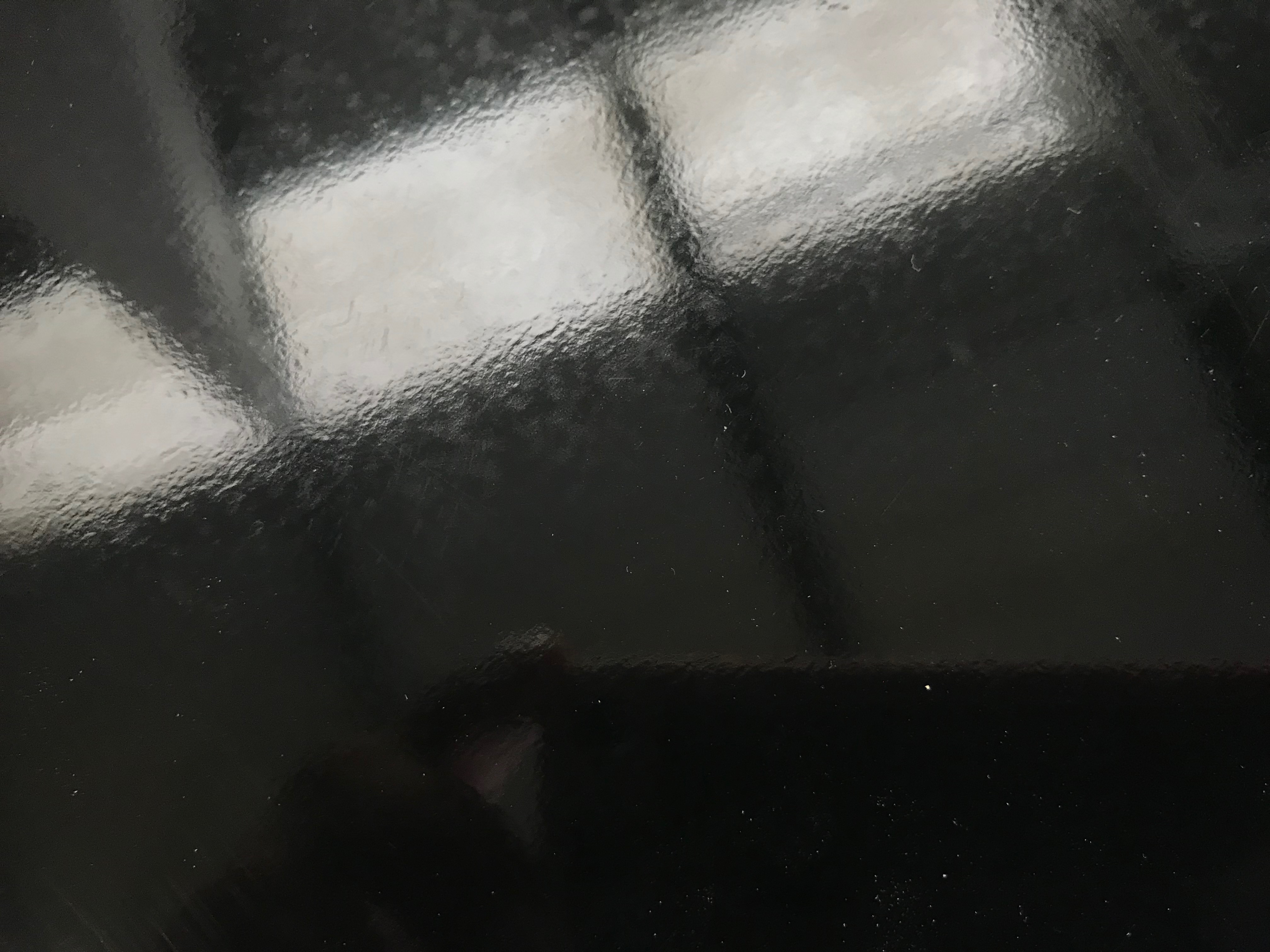

    Any other users of Metamark M7 had this? It seems to be happening more with the black gloss but not limited to just that colour. Tried cleaning it off but doesn’t seem to budge? Looks like a very thin layer of tree sap. Obviously not but thats the only way i can describe it. It had not been under heat, machined in any way, just off the roll onto a sheet of composite.

    You do see that on a number of manufacturers gloss black. You could try heating it with a heat gun..

    It’s something in the manufacturing process, a rep did tell me once but i can’t remember exactly what it is. It’s far more of an issue when it’s on a wrap vinyl you’re fitting to a high end car…
    20 August 2018 at 09:55
    various reasons you get imperfections like this on the surface of the vinyl.
    a common one is it being too tightly wound, then left for a long period of time.
    as a result, the paper on the rear can have this effect on the face of the film.
    same applies when you get not only this blemish on the face, but you also get a spiral line on the face.
    the line comes from the card core that the vinyl has been wound onto but normally only effects the last metre or two on the core.

    Agree with John, a gentle heat often removes marks like this
