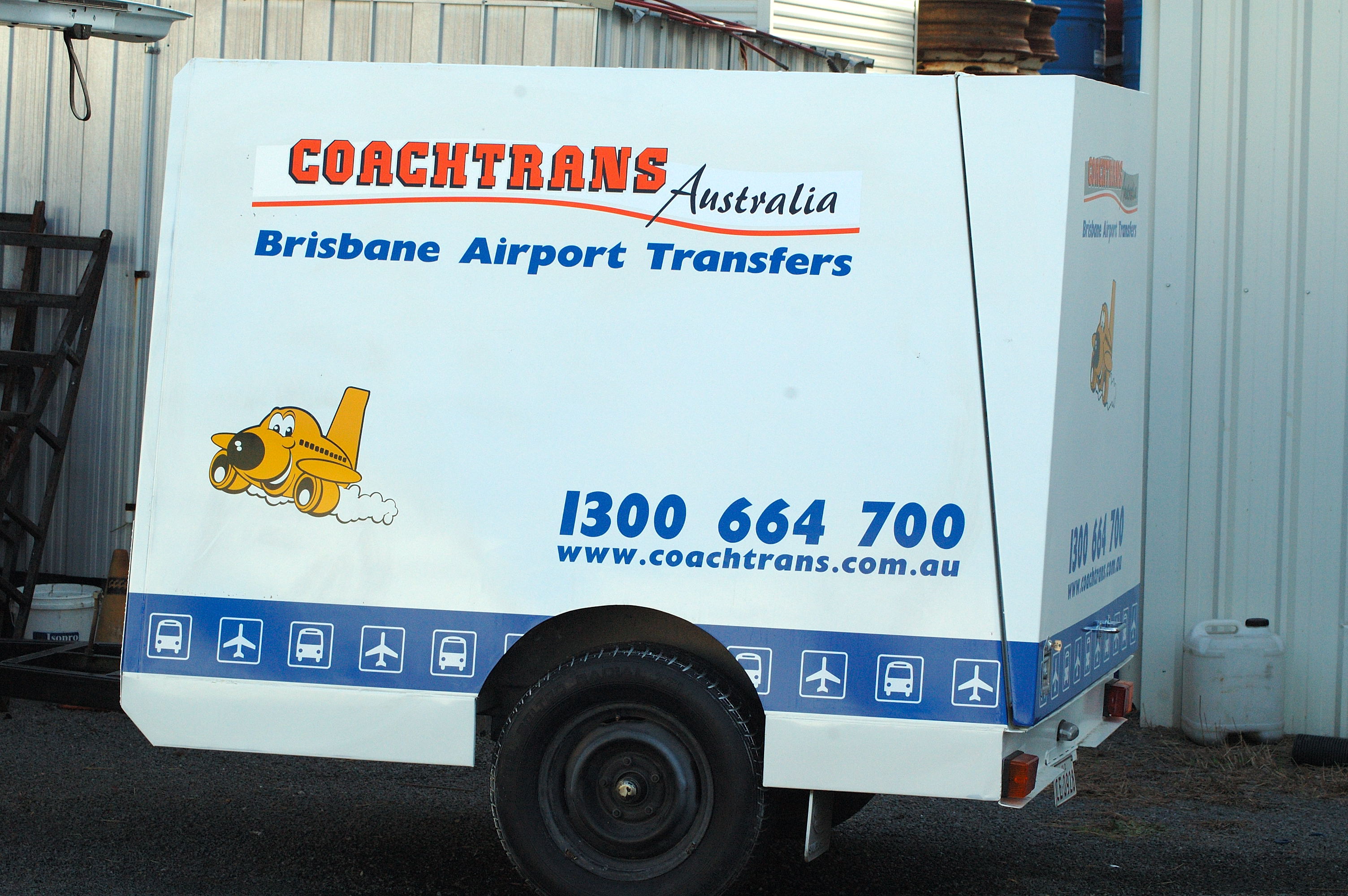

    Posted by Shane Drew on 13 September 2006 at 11:32
    Yellow and Orange is reflective Oracal 5700, the rest is Oracal 551.
    Actually took longer than I thought it would because some dweeb painted the thing on the cheap and didn’t undercoat it.
    Masking tape pulled the paint off, so I had to do most of it wet. Not sure how long it will last before the paint falls off completely, but the owner saw us having probs, and told us to do the best we could.
    What should have taken 2 hours actually took 4.
    Customer paid, so that was a bonus 😕

    13 September 2006 at 14:09
    That’s cool Shane, but boy, you sure have some funny looking airplanes down under…that thing looks like a trailer! 😉
    It’s a shame the airplane graphic isn’t bigger, but with how the paint is it sounds like you were on a tight budget.

    I agree mate, I wish we had gone bigger on the plane graphic too, but yes, the client didn’t want to spend anything, and I wanted to charge him a fortune, so we had to settle on a compromise :lol1: :lol1:
