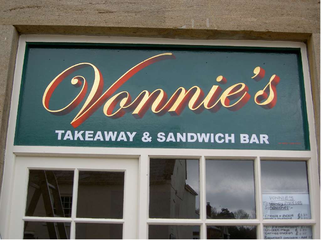

    Very nice .
    What a pitty you haven’t done his price list to match, I hate it when people get lovely signs made up then use their home computer or just hand write other messages on their windows, and add stickers to their vans.
    Lovely job, how long did that take to make?
  • A Misselbrook
    16 June 2005 at 15:10

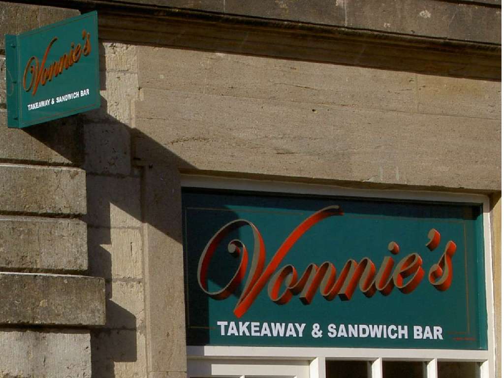

    😉 I added the name to their A board so they dont just have the bit of paper in the window! I know what you mean though.I’ll try and convince them to let me do them a menu!. The fascia took a few days back and forth, Paint the background (day 1), draw out and goldsize the lettering, gold leaf(day 2), add shadow and white lettering (day3) I did pop back and add the border when I fitted the projecting sign.

    Well impressive, is it all done free hand?
    (never seen anyone attempt work like this before)
  • A Misselbrook
    17 June 2005 at 23:23
    Thanks :blush:
    Its just me, my one shot, my brushes, my mahl stick, my gold size, my gold leaf and…….an egg!! 😎
