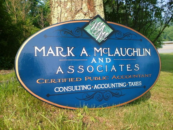

    Here is one I posted about awhile back.
    It’s a Stevo design and installation.
    He cut it out & I painted it.
    The customer was very pleased.
    We had about 3 days work in it.

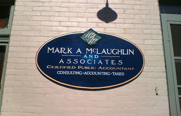

    It looks kinda fake on the building, but I guess it was because of the sun.
    Love….jill

    Oh wow, fantastic job as always guys …. Its great to see the finished result after the design off you had.

    It looks great. That is funny how it looks fake. The mock-up you did before looked more real. 😀

    another superb job jill 😀
    so the customer went with the round one 😛 😉
    looks good

    Wow , that’s a beauty !
    Is the background painted with a fade?
    We need a step by step on that one Jill, fantastic!

    Thanks Joe.
    As that was my first painted radius fade, I had a bit of trouble.
    Next time I do one, I’ll take pix.
    It was a pain, as the surface seemed uneven to me.
    I needed to use Penetrol to extend the blend time.
    With a straight-up roller blend it’s easy-peasy.
    I ended up clearcoating it with 1-Shot UV in a can,
    and that evened out the background brush marks.
    Love…Jill

    Looks fine to me on the building too (but then I am well into the beers now 😮 ).
